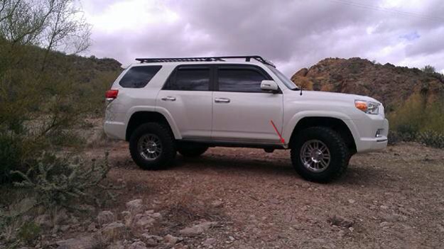

Your pictures show a trail, but on an 2010-2013 SR5 or Limited there is a piece lower of the front fender flare. When you take it off there is a bolt area that's exposed. Do you guys make them longer in the front to cover that up?
Also how/could you use a high lift jack and not bend the body with these?
The red arrow is pointing to the area.
Photo from [MENTION=73151]brockeverly[/MENTION]
It will disappear out of sight if you paint that black before installing the rockers. It is not in the way.

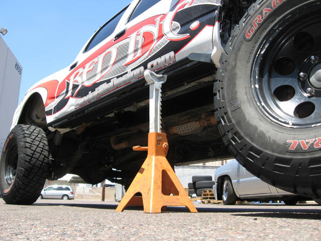

I have been running a set of these on my 4 door 01 Tacoma for years. It is not a rock racer that jumps ledges and lands on the rockers every weekend, but it gets used hard! They have no problem supporting the weight of the vehicle. They covered up my previously damaged sheet metal and now when I drive over a ledge or rock they just slide until my rear tire reaches the obstacle.
One more thing.. Even tubular frame mounted sliders flex until they hit the body pinch weld. Then the body pinch weld supports the the tube. That is why all the nicer frame mounted tube sliders have one of the tubes that run directly under the pinch weld.
