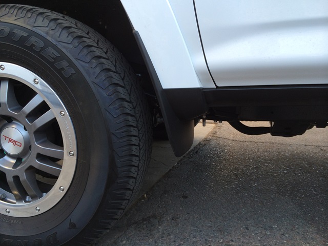

AND, we will have a factory Toyota corner for the SR5 guys that makes the lower flare the same as the Trail Edition. So the Rockers will look the same on both. These will be available from Toyota 4/2014 (or us).
Can we see a SR5 with the setup?
This is a pic of the corners. They are what now come on the 2014 SR5 4Runners.
Any difference for the LTE? I have one without factory running boards that I would like to equip with your sliders. Thanks in advance.
I am so confused, is the slider there already in that picture? Any clearer pictures? :confused:
No slider in that picture. I don't think that piece will line up with the 2010-2013 LE/ SR5's (I could be wrong). The slider is a good idea, but I'm yet to see them with this piece on a 2010-2013 LE/SR5. I know he said it's not available till 4/14, but showing a stock picture as an example of your work that doesn't have your work in it is not helpful.
This is a new product and a new way to mount them. I've asked for clarification, unfortunately he wants to push his product on here and not have to put any effort into it. I don't get it...lots of opportunity here can be had with minimal effort.. Again great idea, not so clear on the marketing.

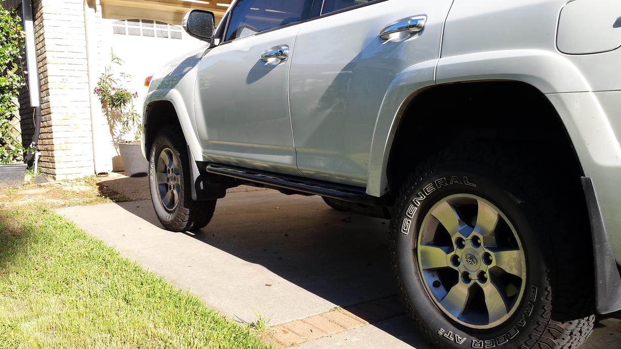

Just put a set on my 2013 SR5 the other day. I did not want to trim my rockers or buy the TE rockers and these fit that criteria. They look great and are stout. They weigh around 40# each. The install is straightforward, one thing to note is that the 3/16ths rivets that are supplied are steel, which is great for strength but they are a ***** to put on if you have a hand riveter, best to find a shop/friend with a pneumatic one. Randy and his crew were very responsive to all of my questions and the sliders were delivered on time, 4-6 weeks. I would not hesitate to do business with them again. I also ordered the caps to (I) finish off the look of the front fender and (ii) to have something to attach the factory mudflap to. The pics exceed the size limit, so I will have to take some lower res ones to post.

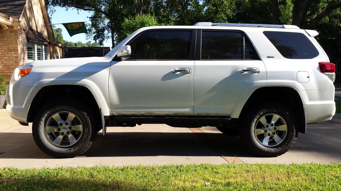

That looks great, makes the 4runner look like its has more lift.
This is a great solution for those with SR5 and Limited models, no need to cut up the stock rocker panel, or spend 270 on shrockworks rocker filler trim.
