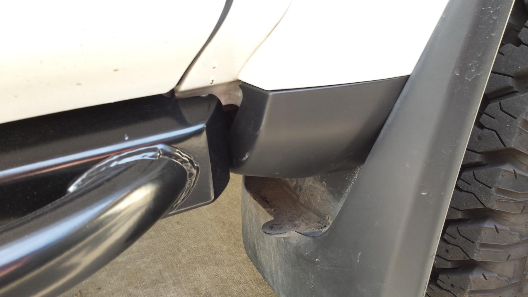

Is the cap at the front built into the mudflap? Did you have to buy the ones for the rear separately.
No, the cap just pops in where the factory rocker was attached, which gives the mudflap an extra attach point or two, without them the mudflap will flap around, of course you could always take them off. Apparently there are no caps for the rear, which you couldn't use anyway because the rear of the slider would be in the way. The caps run about $30 each. I got mine through RED, but they are also available through other sources online. The part numbers are 75857-35010 & 75858-35010.

Here's a pic of the front cap. Notice the tab sticking out from the mudflap, that where the bottom of the factory plastic rocker was. I didn't do a before and after measurement, but by removing the factory running boards and rocker I'm guessing you gain around 8" of clearance on the sides.
