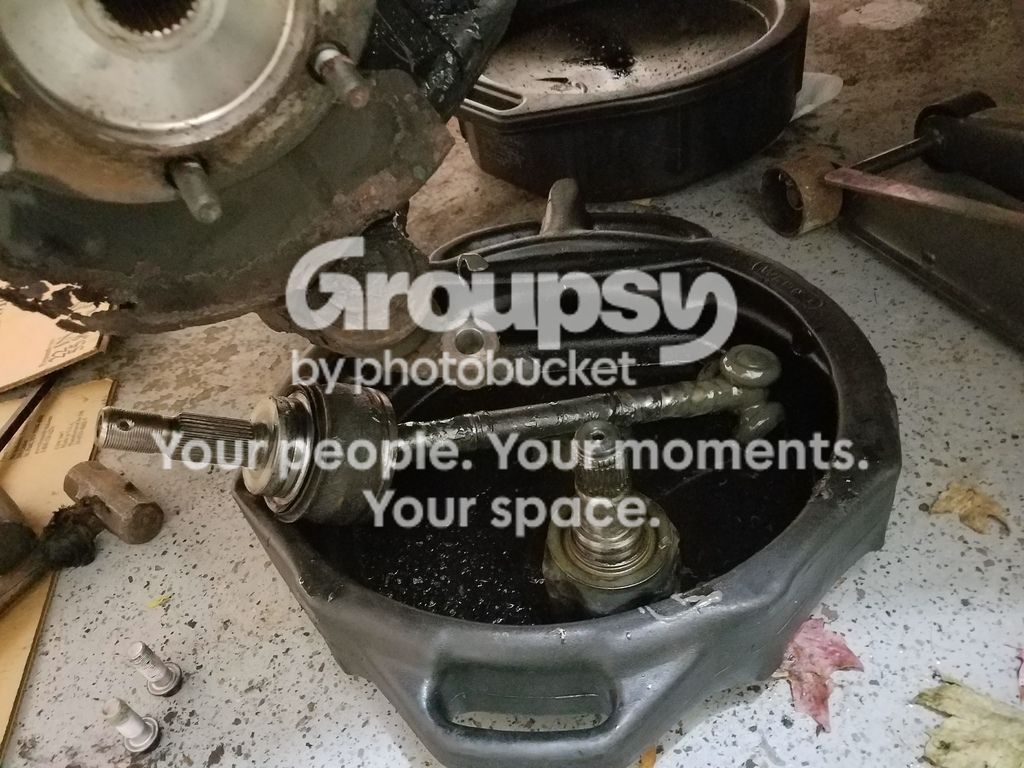

20161105_222429_zpsinqrc4jw.jpg~original
$640 bucks for a bearing swap and CV replacement. Man am I glad I do all my own stuff.
I just did ABS sensor wires, rebuilt my drivers CV, all new front brakes (Calipers, Rotors, Pads, and Lines) and Wheel Bearing for about $300 bucks. I chose to re-boot the OEM CV axle because its just a really stout unit. Whole project took about an hr and a half.
Mine is an '04 with 137k and is an extra vehicle for us, but my LCA bushings are in rough shape as well, RUST SUCKS. Ball joints all feel great though.
I did it myself last time, but I don't have shop access anymore since I moved. The CV boot had been torn and leaking grease for at least 3 years with no noticeable symptoms, but I didn't want to have murphy's law bite me. I replaced all my calipers with refurbs from Advanced when I found seized pistons on both front sets. Three years later one of those seized and advanced replaced it under the lifetime warranty. Even gave me a replacement rotor and a set of pads since it killed those when it went.
