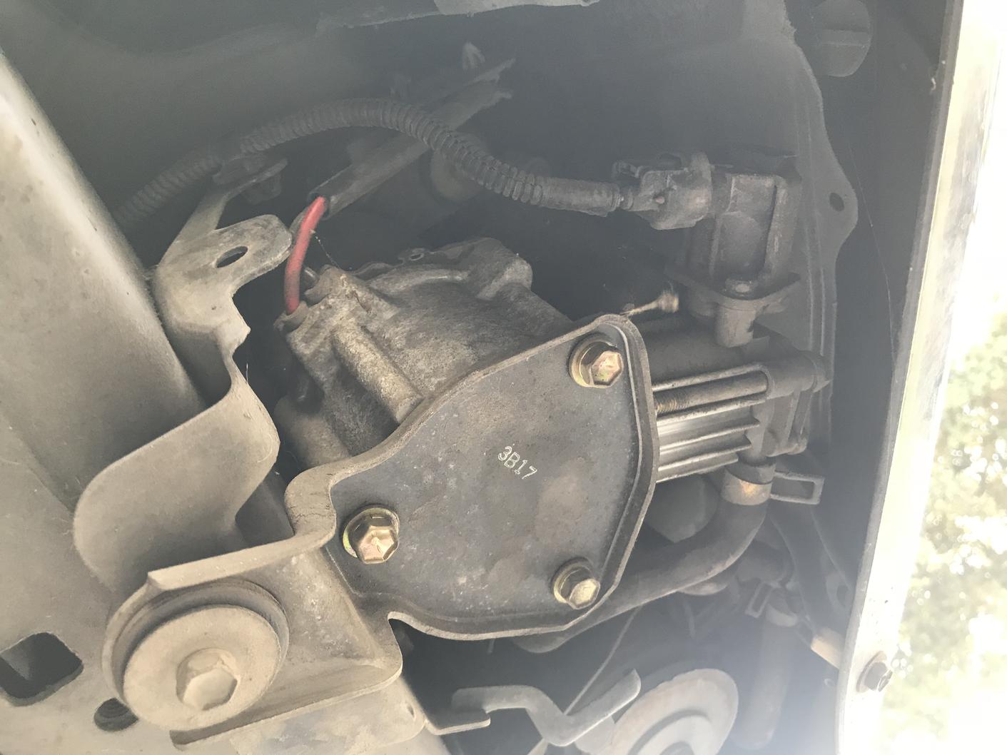

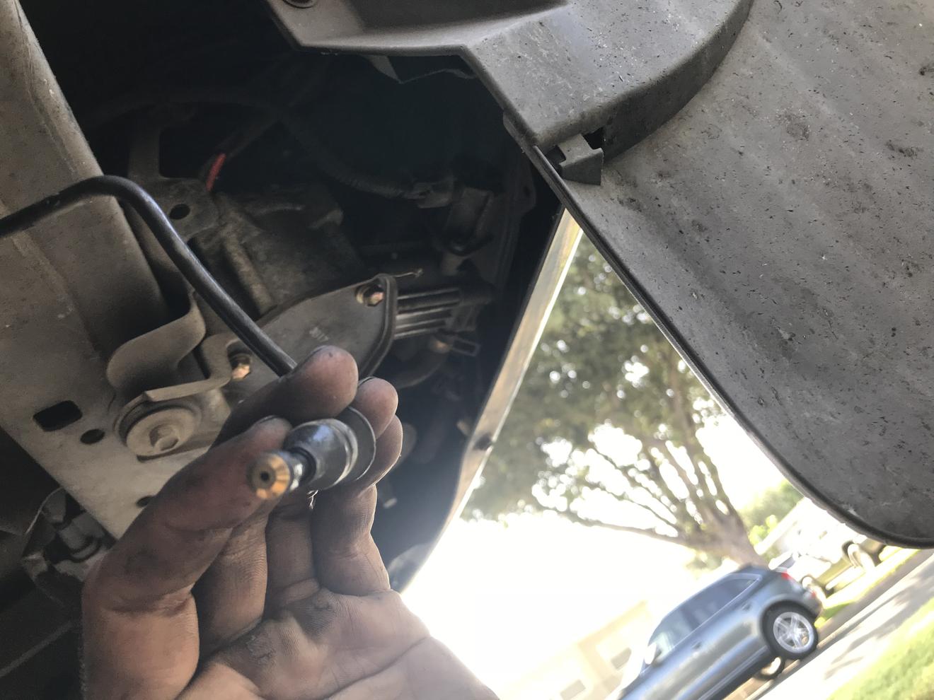

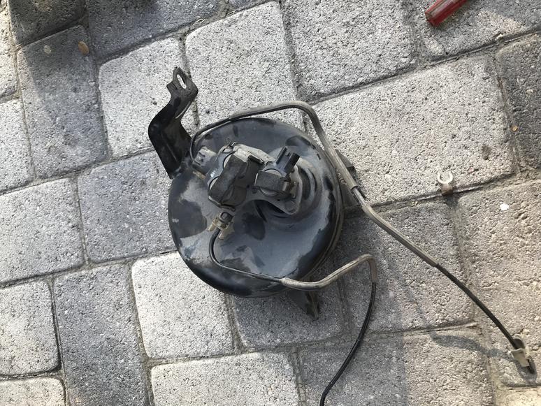

03 limited v8 4wd. Swapped in bilstein 5100 with Tacoma coils up front and Fj coils in the rears with sso conversion kit. I removed xreas and all the lines. I removed airbags and the lines connections. There’s a question I have, there’s 3 lines from the “pump” 1 to each airbag and 1 to the left rear corner of the bumper. Looks like the compressor? I was going to remove it but it looks like it’s connected to something else? Evap/charcoal canister looking thing?

I know what you are talking about. Doing my RAS dwletebthis weekend as well. I'm not sure what it is. But my best guess is some kind of small expansion tank or something. I'm pulling mine this morning.
Let me know what you find/figure out? I just didn’t want to pull it out and fail smog inspection here in California.
