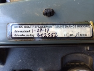

There should be a sticker somewhere that says when it was done. Mine was done at a dealer in Newmarket and the sticker is on the throttle body cover.
Even if the belt looks OK, there's no way to tell in situ if its stretched, ready to jump a tooth. The tensioner is also a critical part in the system, hows the bearing in it?
If you get it done at a Toyota and Lexus dealer they should put a sticker on the radiator support. Lexus is much better at doing this than Toyota though.
Wow, what's that your 5th t-belt?!?!...Hope mine does that good, it'll be due for its third next summer.
