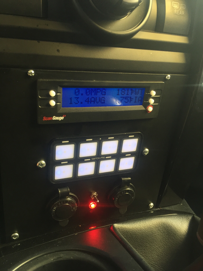

Finished the install of my switch panel made by Front Panel with flush mounted scanguage, switch pros, camera override dongle switch, cigarette lighter, dual USB port, and a indicator light for the secure idle
Express
First downloaded the Front Panel Express software and spent a good chunk of time measuring all the individual pieces and the layout. In the end I received this peice of aluminum in the mail a little over a week after I hit submit
I then pulled out the head unit and set off on dremeling out the rear of the OEM cubby space so the new panel wouldn't have any clearance issues (failed to take a picture of this) the new panel is flat in comparison to the OEM and had to be spaced out about a half inch. I then powder coated it and went about wiring it up with the help of a friend.

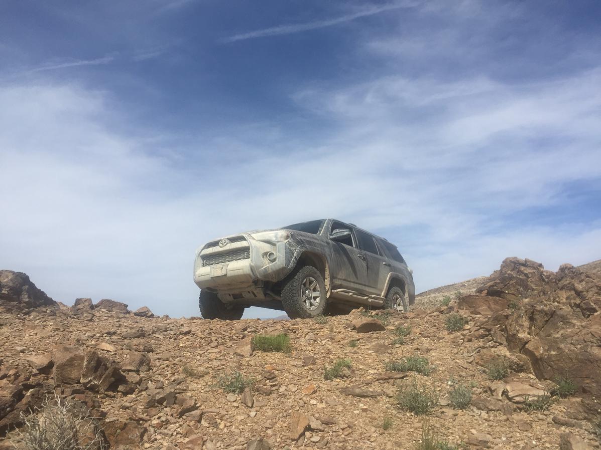

Spent a few days traveling through Death Valley
