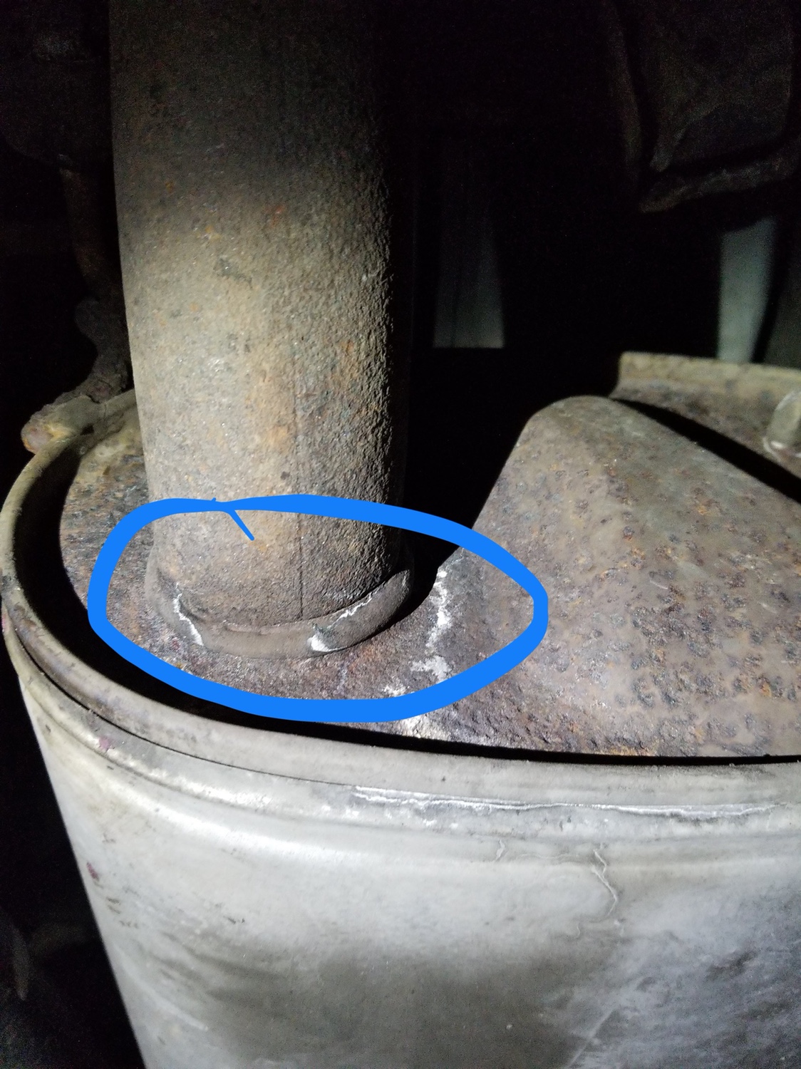

I also had a rattle coming from my muffler. Turned out to be the joint between the muffler (big oval component, not the resonator) and the outlet pipe leading to the resonator.

pretty soon your muffler tailpipe will break off. seems pretty common. ive welded it back a couple times but wont last forever. last time i just removed the entire tail pipe then stuck a turn down pipe in the back of the muffler. if i replace exhaust manifolds then i will prolly replace entire exhaust
