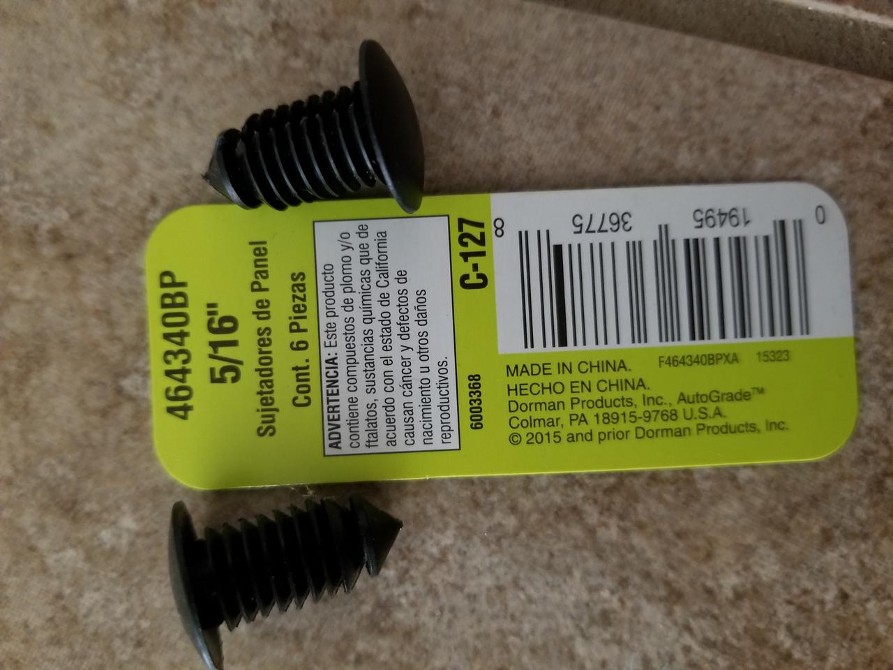

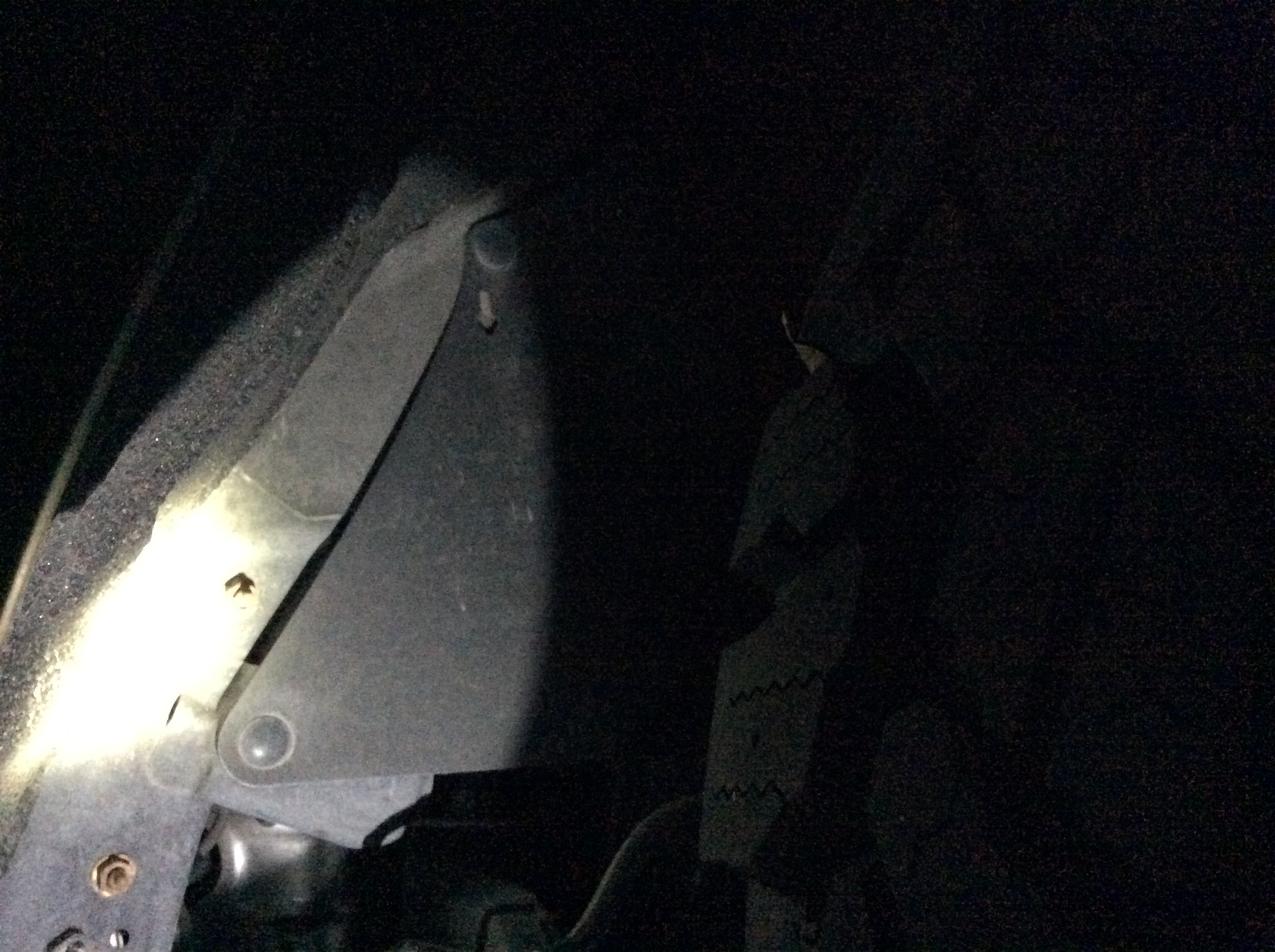

Its more then likely the engine mud guards. I replaced all of the fasteners(push rivets).. and my squeaks are gone
Historically the Problem
The plastic guys holding the engine mud guards have historically been the problem. There is a write up about how double sided tape was a solution.
