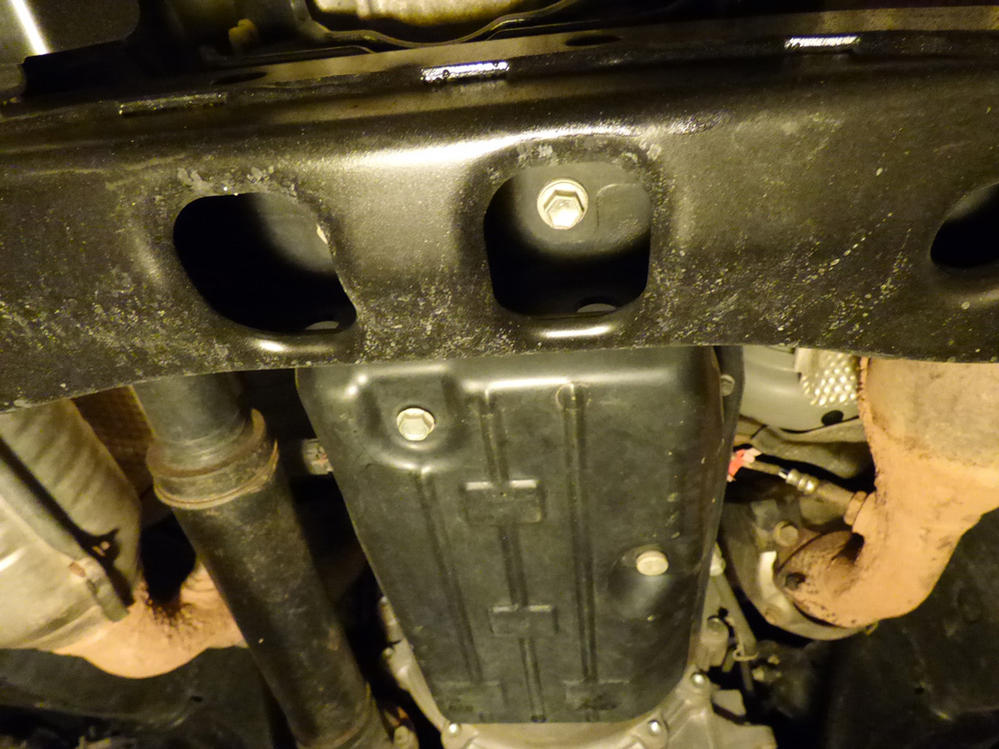

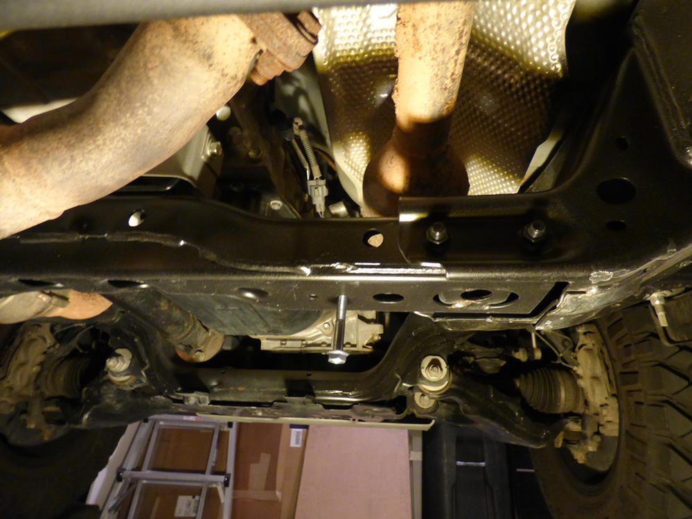

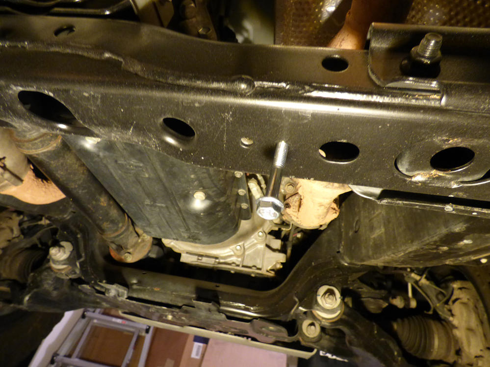

I am lost on the bolt situation for the cross member.
There are only 6 total bolts that I can find in the cross member, 4 that attach it to the frame that run horizontally and 2 that attach to to the t-case or tranny.
There are 4 holes that look like they line up with the skid plate holes but the bolts are way too long. Am I looking on the wrong spot.

Did you completely remove the diagonally mounted support tubes that one end was bolted to those two holes?
The diagonal tubular support piece needs to stay attached. That takes up like 1/2 inch of space spacing the skids downwards and using up the rest of that bolts length when you sandwich all three items together using those holes.

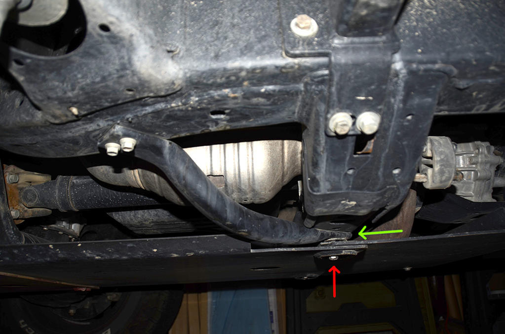

Here is what it should look like (With the skids installed)
Red is the 50mm (2in) bolt in use. Green points to the diagonal which uses up 1/2 inch of that bolt...
If no diagonal, you can get shorter M8x1.25 bolts from Home Depot.
Aaaactually, now that I think about it, you can't use shorter bolts as the skidplate will likely hit the exhaust. You need to use a spacer or even a stack of washers to space it down.

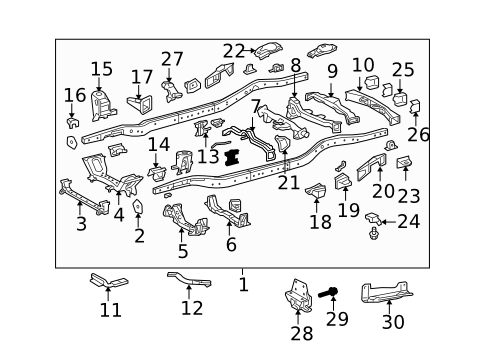

Toyota diagrams are terrible. Having a hard time picking out the correct part. I am guessing #12
That was my guess when I first looked at the diagram, nothing else seems close.
