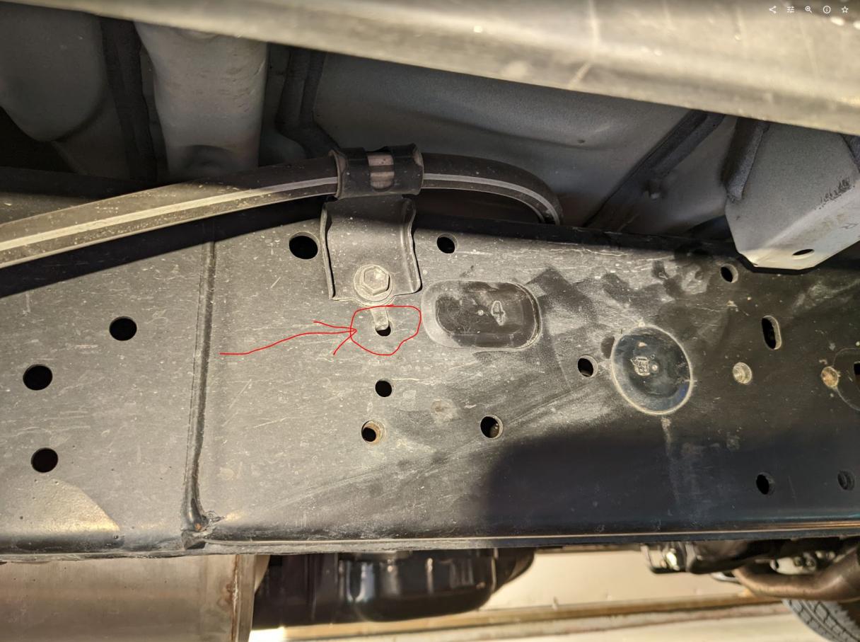

Installation Question!
I hate to resurrect an old thread but how did you deal with the emergency brake mount during installation. Once you add the thickness of the rock sliders the tab no longer is long enough to fit in the frame hole. I really would appreciate any help you could provide.
I included an image.

i just put my RCI sliders on my '16 TEP w/ KDSS monday.
it took me about 3 1/2 solo, and without any jackstands etc.
i used a plastic toolbox i had to help hold them while i moved them into place. once i could get one bolt at the opposite end of the toolbox, it was easy to get another in and go from there.
regarding the e-brake tab, i just cranked it down and it moved into the slot cut in the slider plate. don't think it fully went into that hole, but i don't think it's going to move. i had a time getting that bolt in, i guess that bracket was tweaking the angle, but it wouldn't go in.
the driver's side w/ KDSS was a bit more "fun". ugh. some of those bolts are really a pain to get to to tighten down. a few the socket wouldn't fit, or you could only get one click at a time on it and it took 15 min to crank down one bolt.
