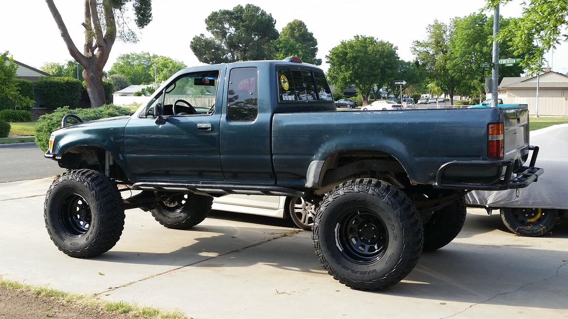

I thought about that considerably but the RCV "IFS CV axles meet and exceed the strength of a straight axle swap, while allowing you to maintain the traction, smoothness and control of your IFS." And solid axle swap would probably run me double the $$$.
The axles feature a double-offset inboard CV joint that is comprised by 1-inch balls and 300M internal components. The outboard CVs utilize our Dana 60 architecture with combination of 4340 & 300M components optimized for maximum strength. The center bar is 35 spline 300M, the strongest in the industry.
Basically it is a bulletproof IFS setup for half the price of a new SAS. I want to maintain the on-road drivability of my 4Runner so this seems like the best and strongest option to still balance maximum off-road ability with on-road smoothness and drivability.
