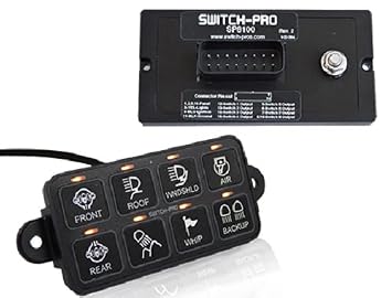

I have seen people here have used the SwitchPro and I really like it, but it got me curious as to other high end options.

Not to deter you from doing some revamping of your wiring. I'm sure, judging by your attention to detail and obvious wiring knowledge, you're already aware, but just for information sake and the spreading of knowledge... Sometimes, newer isn't always better. Relays, fuses and switches are a solid performer and easily diagnosed and repaired in the field should a component break or fail. All of the options mentioned in this post so far (spod, switch pros, etc) use circuit boards, which are nearly impossible to diagnose and field repair.

You make an excellent point... and I agree with you.
There are a few things I want from this systems that I can't really have without a logic board / controller.
That said, I was already thinking to add a redundant secondary circuit for my critical item(s).
I was thinking of taking a dual relay, and on a single throw mechanical switch, one would open the circuit of the SwitchPro, and the other would power the load (ham radio). Redundant alternate path for power, no chance of back feeding the switchpro.
