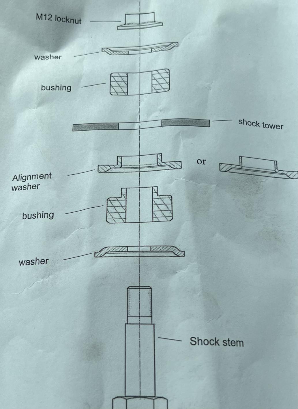

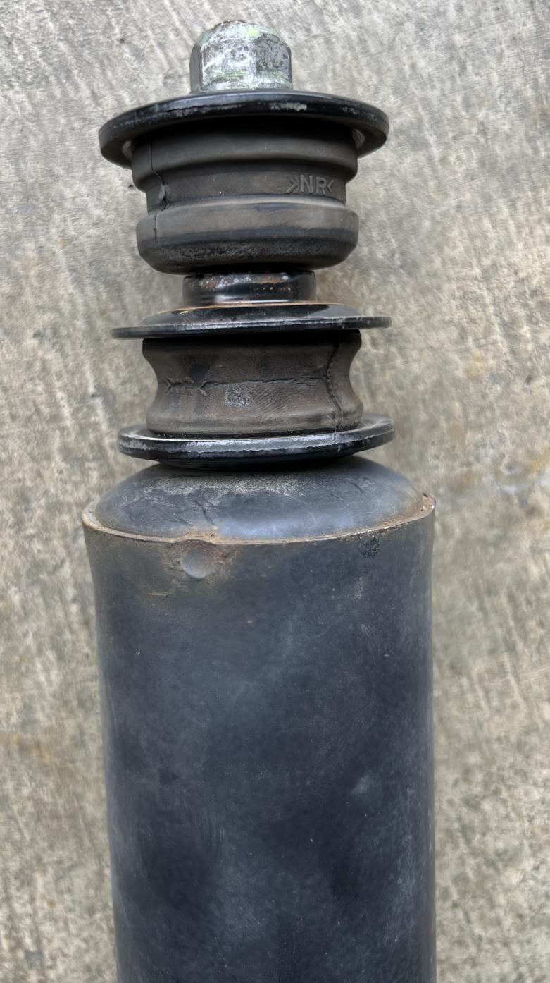

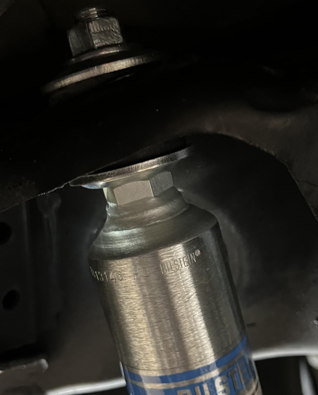

Installed rear 5100’s last night when done I noticed Bilstein instructions show the bottom washer facing down and upper washer facing up.
Whereas the stock shocks have lower washer facing up and upper facing down. Wondering do I need to redue per Bilstein instruction.

Here’s the Bilstein instructions, forgot to add pic.

Follow instructions from bilstein but if you dont notice any issues it should be fine. i plan on installing mine next week any tips to make install easier?
Watched a few videos afterwards as well, they all put them same as I. I was thinking about re-due today but my back hasn’t recovered from the other day.
I take into shop tomorrow to have the fronts installed, I’ll just have them flip while up in the air. I’m not as young as I used to be, when I did same on my 15 it didn’t hurt.

Installed 5100s on the rear today and it took about 45 minutes to complete both sides. Very straightforward and did follow instructions per bilstein. It probably doesn't matter which way the washer goes. Only issue I had was removing the brackets that held the reservoirs from the 5160s. I left one on since couldnt get it off, will try at a later date to remove it.
*little pb blaster helped remove reservoir bracket
