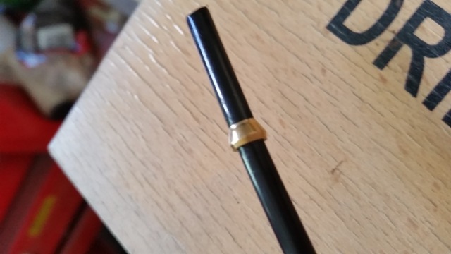

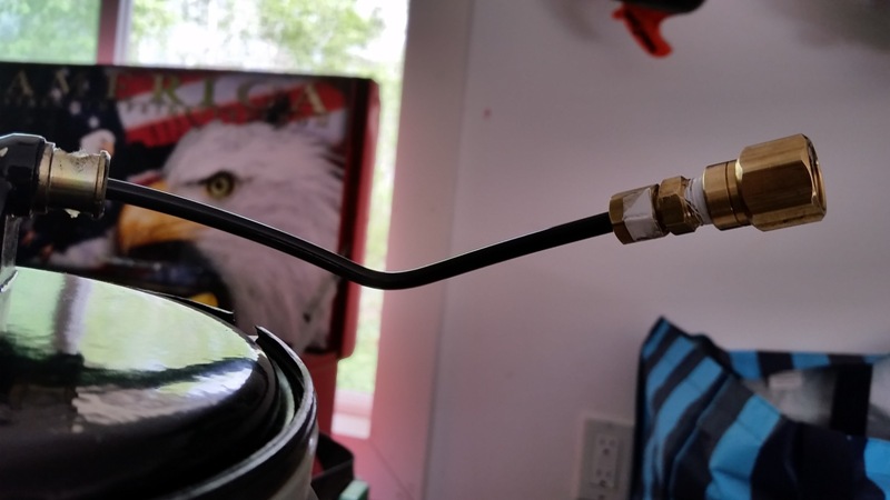

Update: Put the air springs in. Had a few issues here and there. First problem was lack toyota oem air tube. I ordered one and got the wrong one. I received the one I ordered, but it wasn't the right one. Apparently there are a few different ends, so you need to make sure you get one of the two that actually goes into the spring, not one of the other 5 tubes that go different places.
BUT... if you're reasonably handy you can make up your own end. It's 5mm OD plastic tube. So... in the USA the closest thing you'll find is 3/16 fittings. Ace hardware has a lot more than a HD/Lowes kinda place. The portion that goes into the air spring is a tube section with a flange about 3/4" back from the end. A 3/16 compression band with about half ground off then used in a normal compression fitting will compress the band onto the 5mm toyota tube and makes a perfect end to go into the OEM airbag end.

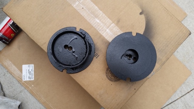

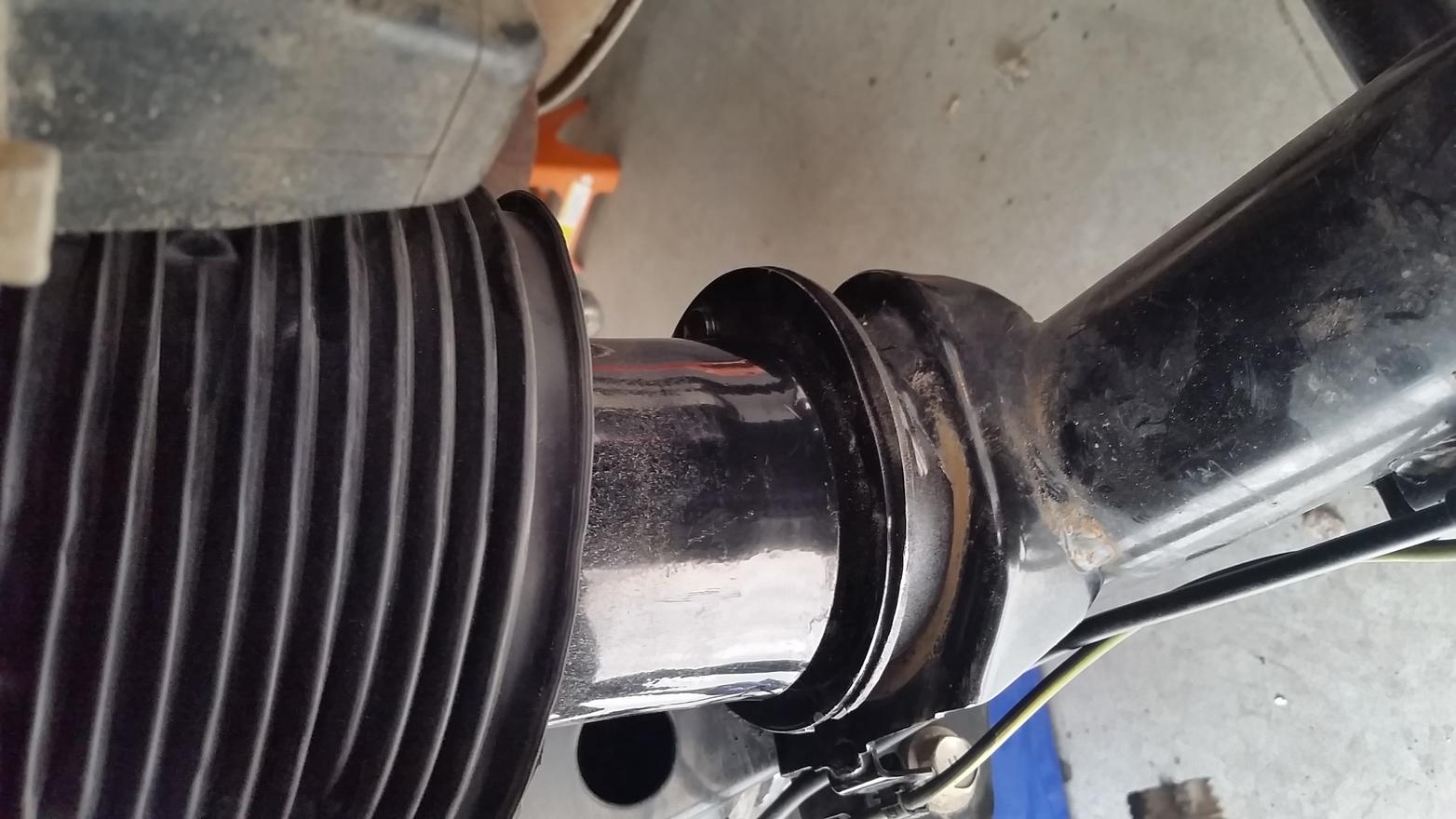

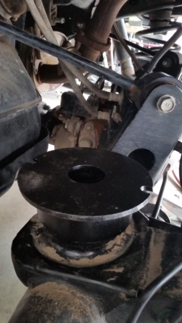

The lower mounts are self explanatory. The crappy part is that it turned out to be way too tall. At the low end (40psi) I was still about a 2.5" lift. My goal was to be OEM height at low pressure and 3" high at high pressure. So... I'm making some new much lower height platforms - but I can still only drop at the most about 1". Maybe 1.5. So my low height will be about 1" high of the OEM springs. Of course with no pressure it'll be more like 2" low of oem height, but you can't really drive like that. It will be nice for hitching a trailer though. No need to use the tongue jack.
You can see the rest in the pics. I'll put some other pics in tomorrow once I get it dropped down where it needs to be for my goals.

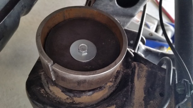

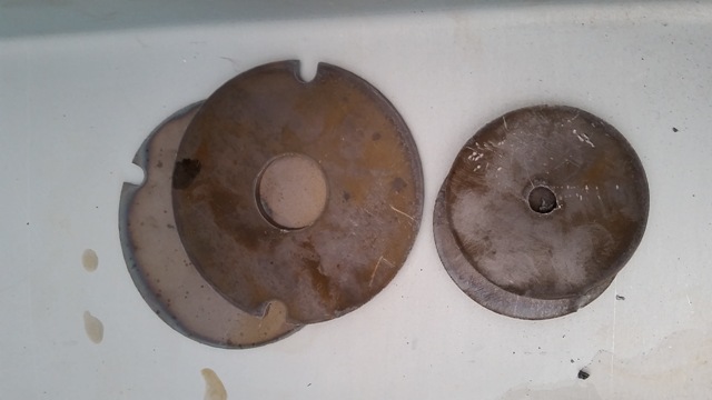

Update. Today I made the new base brackets. The good is that they sit about 1.25 inches lower. At 50psi in teh airbags it's perfect height wise for what I wanted. I can drop another 3ish inches down to the bump stops if I want, but they're too soft at that level for me.
The downside is that I had to make them a simple single plate rather than a double level plate with an internal level. In the first version I could bolt them down to the axle so it couldn't come apart. In the second version there's no space for the bolt to hold it down in the middle.
I'll run them like this for a while.

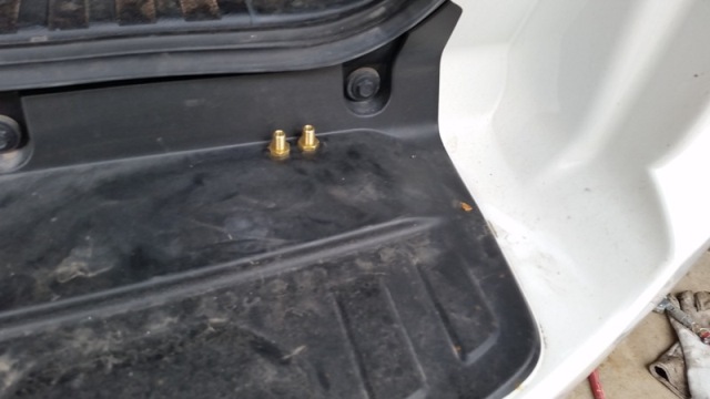

Update: I took a trip to moab with these air springs. I can report that they work fantastic in the dirt. Unfortunately prior to my trip I had planned to install a wireless control box. Basically a home-brew compressor with a manifold, solenoids, and some circuitry for a delay timer so the two sides would have a few seconds after the height adjust to balance pressures, but my wireless relay board was the wrong one and I ran out of time to get another before I left, so I didn't have any on the fly adjustment.

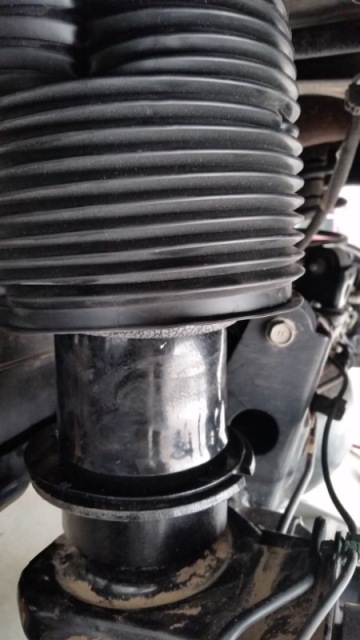

Flex was much like coils - except the springs are just too tall. I'm really frustrated by that issue. They're no more than 1" spaced off the OEM height, but they are probably over 2" taller than I want. I can't really drop the rear down much below what would probably just be OEM height and it's sitting on the stops. In the pic below I'd really like to have at least 2-3" further drop down. GRRRR. So do I replace with generic springs or start cutting up the OEM spring mount on the bottom to get them to fit correctly? Not sure.
Otherwise they've been great. Ride is good. Adjusting up to tall height was great for Moab trails where the rear bumper likes to drag a lot.

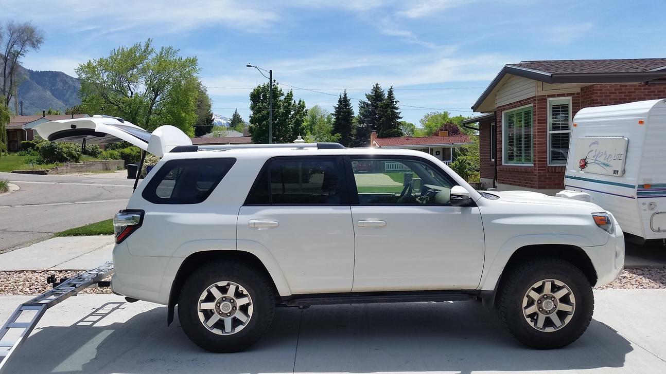

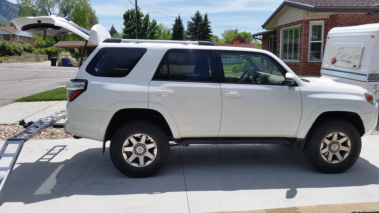

Here's a high/low set of pics. My high limit is the shocks. I think the springs would actually go another 4-5 inches up if I had no shocks on. Not sure why you'd do that, but they have a ton of travel range. The front springs are currently about +2" from OEM. I'll drop them back to OEM height whenever I get around to it. I just jacked it up for Moab. Otherwise I prefer to ride low around town. They're adjustable coilovers so it only takes about 20 minutes per side to adjust the collars. The front is next on the list for coilover airbags.
I had to take my wife's scooter to get safety and emissions testing done. Yes -really... for a 150cc scooter. I hate these hitch carriers, but they do work.
