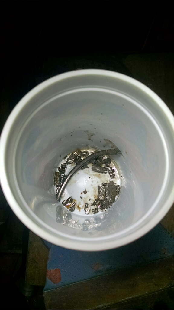

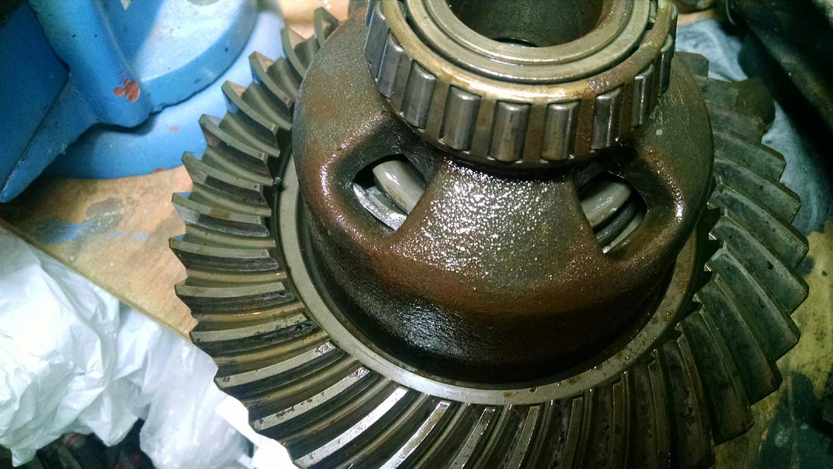

Well I pulled everything apart today, the locker is shot. Can't determine the brand but there are large chunks of metal jammed in there. My ring and pinion are good though uploadfromtaptalk1439848690203.jpg

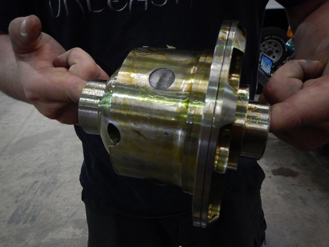

Ordered a Yukon Grizzly locker from Jegs, should be in tomorrow. Tracked down a couple of new carrier bearings and i am going to reuse the old races.
You're going to like your Grizzly. I have one in my 93 and the sucker is bullet proof. I installed mine along with chrome-molly axles, and all seals.
