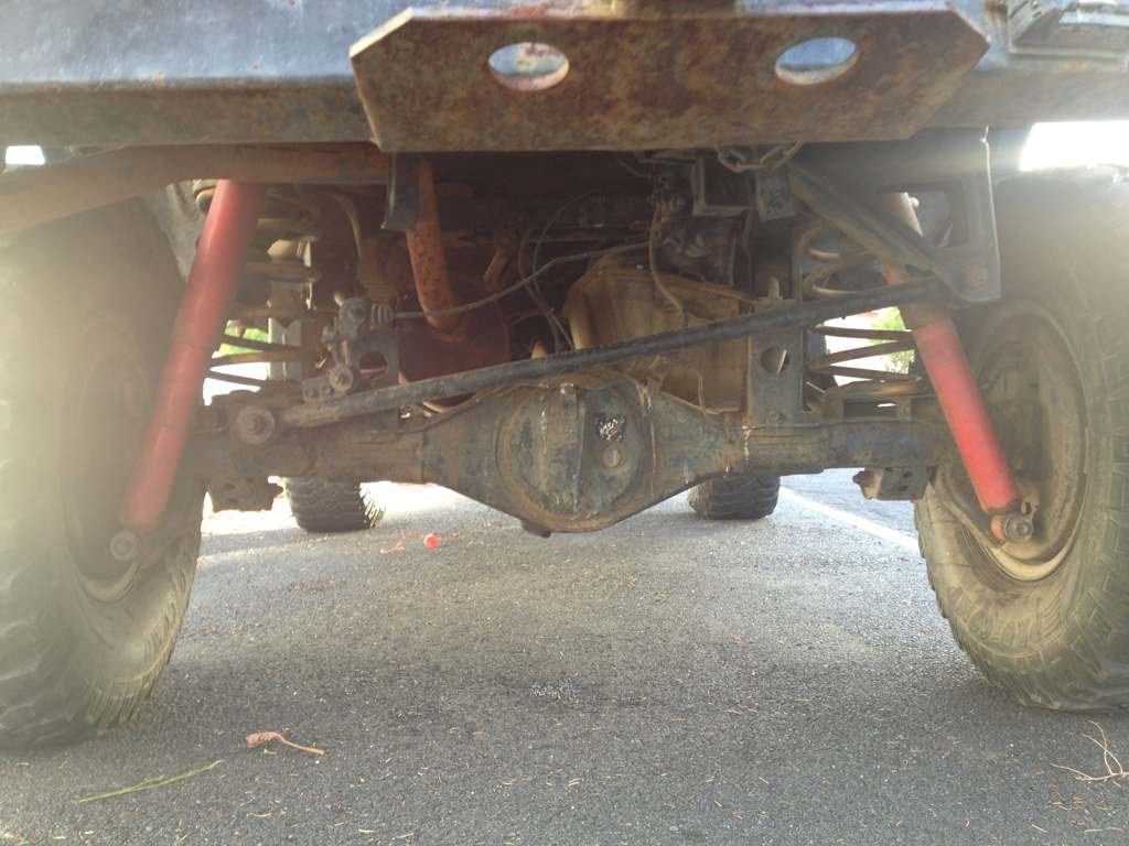

There's a photo of mine. Clearly hasn't been properly done before I got the car. So I can assume that gives me excessive crabbing.
That's a horrible angle. Mine is almost flat at static height. I'll try to snap a pic of mine soon.
