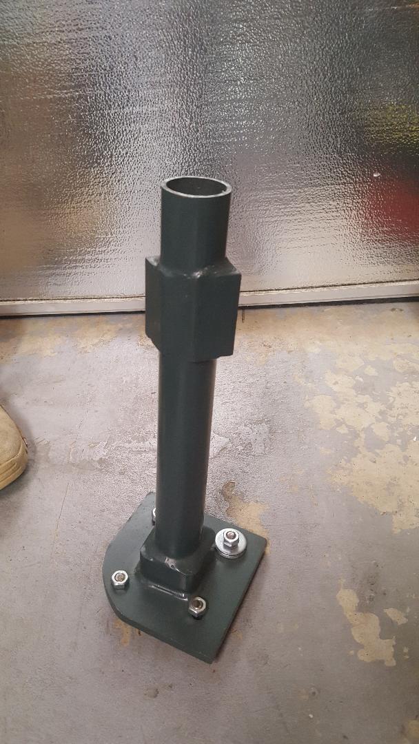

Fixxor, I'm in So Cal(Santa Clarita), I made a tool and have the press if you want to borrow PM me.
