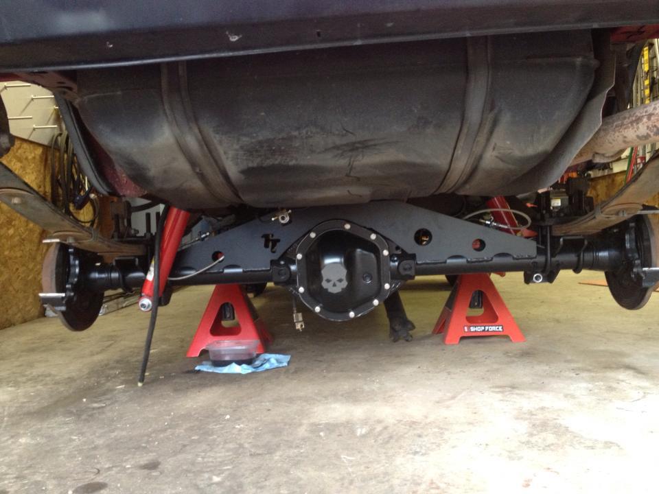

And I'm looking for ideas of some sort of beef up plate 533496_10200130243488744_2099134568_n.jpg

Go to trail gears site or other yota shops they make truss kits and pumpkin kits to strengthen a axle housing.
Does the rear axle really need "beefing up"? I'd say the front IFS components are much more likely to fail than the solid rear axle.

I'm not worried about the shafts themselves breaking, Toyota did a great job. Diamonds are gonna be stronger but I'm just wanting to do a beef up plate/armor project.
This is very true. You're not going to need to do anything to a toyota rear axle housing for basic rock crawling and street driving.
I've done this to a stock un gusseted toyota rear axle for 4 years and its still fine, it also uses stock toyota ball joints in the front end and plated stock arms. Toyota stuff is VERY strong for what it is.

Jon, just wondering, if you are not going to upgrade the front cv's for fear of busting the diff, why are you not afraid of breaking something else at the rear after beefing up the axle housing? Same theory right?
