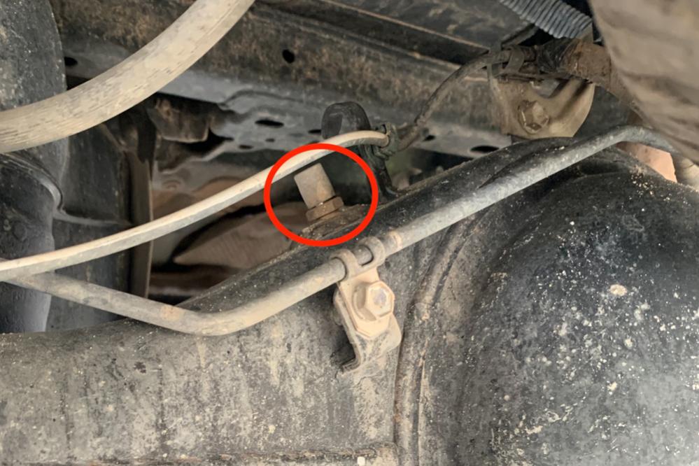

Before doing anything I'd check the rear differential breather vent. The top part of it is an upside cup that should move freely. It's purpose is to vent pressure out of the rear differential and if it's clogged from corrosion the pressure inside the differential housing will have no other place to escape except through the bearing seals.
When mine failed I had differential fluid leaking all over my rear brake and replacing the vent stopped that completely.
If yours is clogged you can free it up with PB blaster and a wire brush-occasionaly tapping it with a small hammer or something. That's a temporary fix until you get it replaced.
Good point. Those little vents are crap. I changed mine to a remote vent, running a 3/8” hose barb, 3/8” transmission hose up behind the gas filler. But you can buy a new vent for $10
