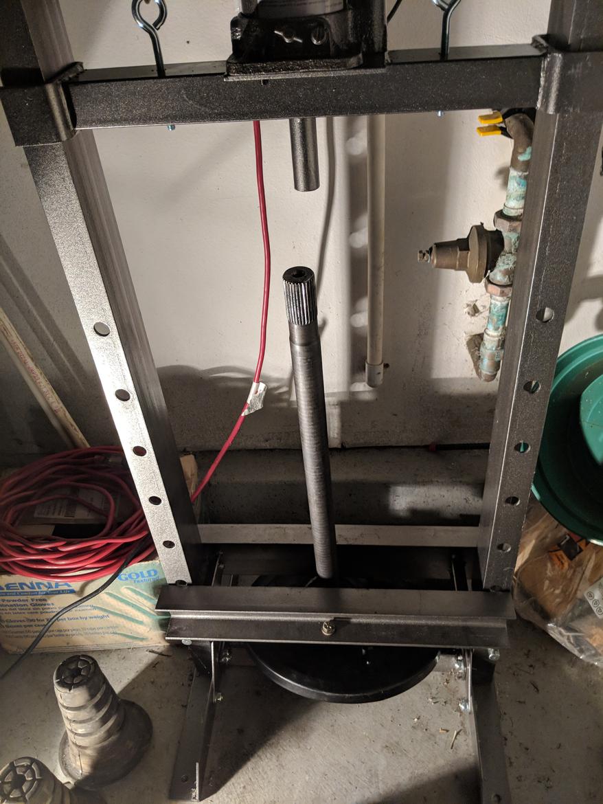

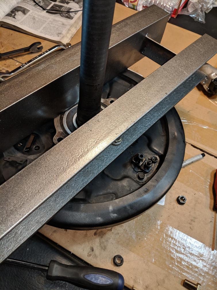

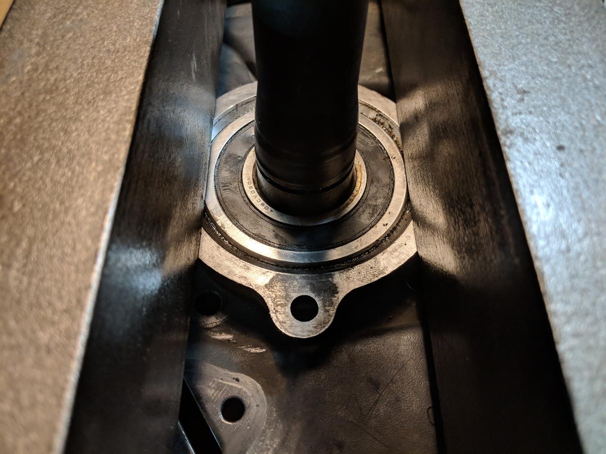

Here is my take... just a couple of holes and some bolts with a 12 ton Harbor Freight press... whala! The 12 ton seems to get the job done with both the retainer and bearing on (although the axel looks misaligned, just scoot the support beam over). I also added some grade 8 bolts and nuts to handle the pressure instead of using the oem bolts.
Also, in the past I took a dremel to the retaining ring and it would pop off from all the pressure once you drill through it far enough. The bearing came out easily in my case.
Sorry for the giant pictures.
