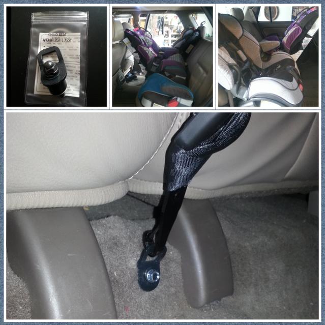

I have 3 car seats in the back of my 4R, the middle car seat is rear facing and I also had nowhere to secure the straps. I'm also using the rear cargo anchor point for the forward facing car seat.
I ordered a OEM anchoring bolt kit, mounted it in a perfect spot, worked out great. Definitely a secure anchor-
Is there a pre-threaded hole there or did you put a nut on the backside?
