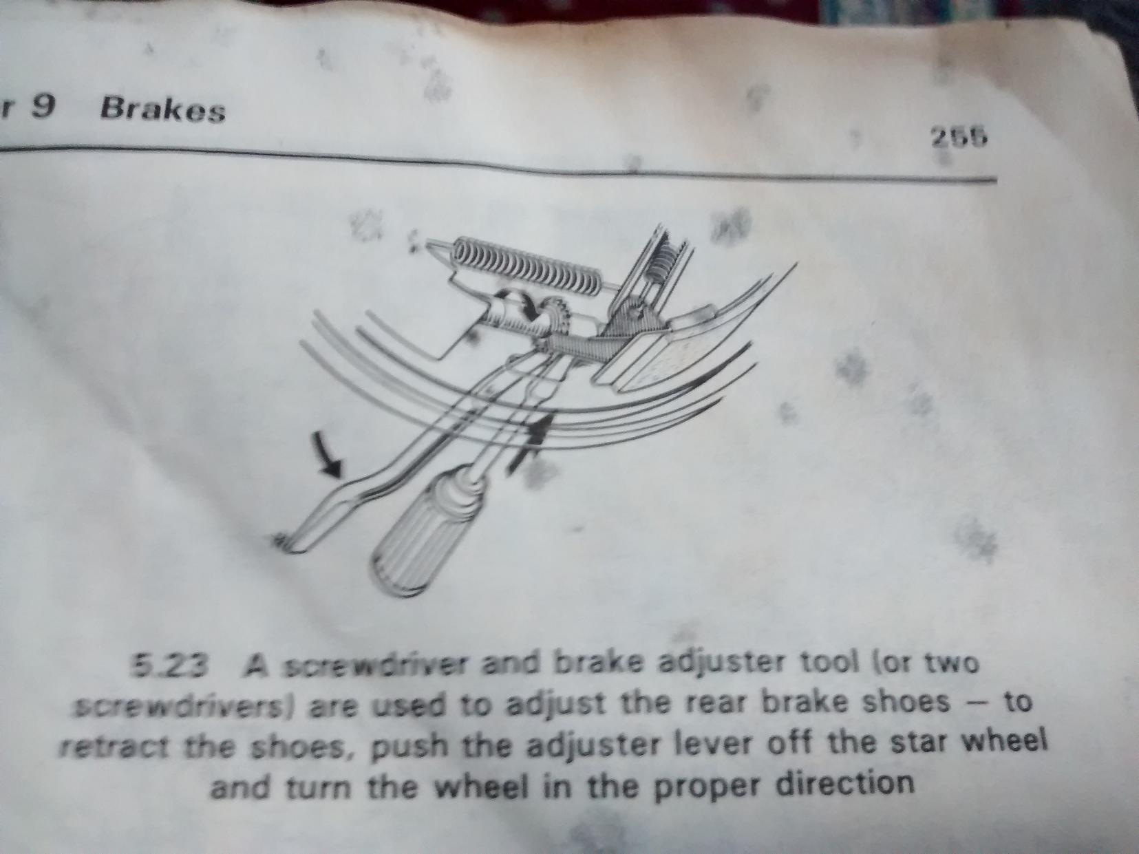

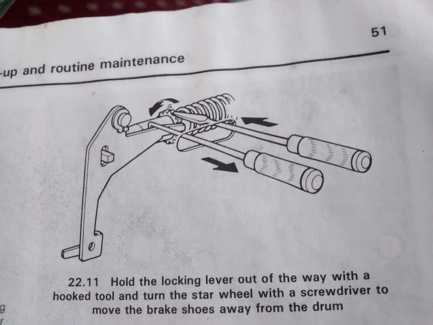

Haynes Manual possible pictorial error.
Page 51 illustration 22.11 shoes Brake Locking
Lever positioned closest to Brake Adjustment access hole.
Haynes Manual, page 255 illustration 5.23
shows Locking Lever position farthest side from Brake Adjust access hole.
My Toyota , the page 255 illustration is the correct picture.
i don't remember the exact year cut off, but the later years were like the top picture.
