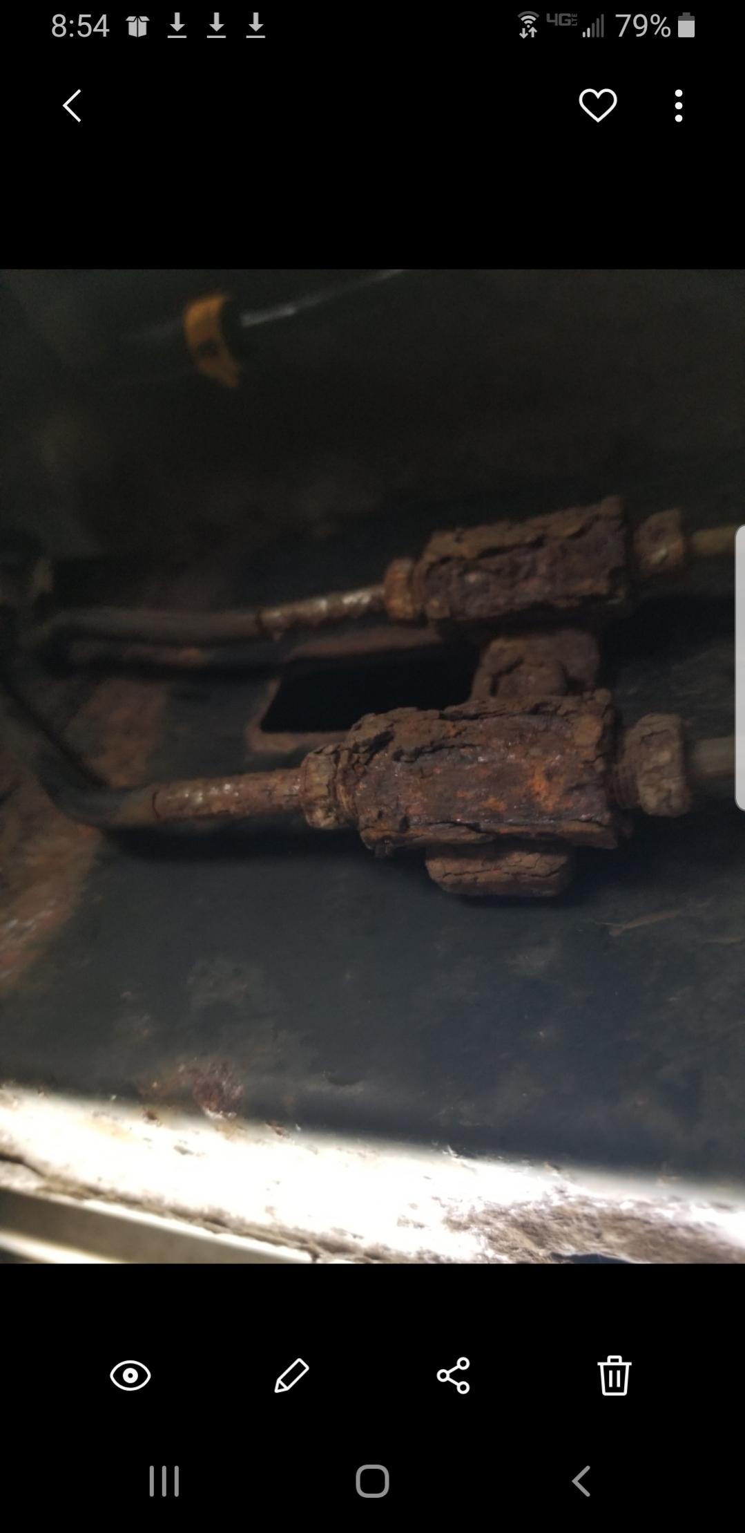

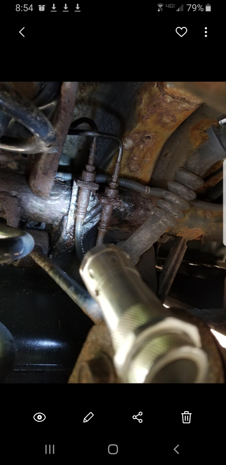

One of my rear brake lines ruptured just behind the gas tank. The ends and fittings of both rear brake lines are very rusted and I should probably just replace everything. Should I just go to the dealer and order all the parts or are there after market venders I should consider? This is 2005 4.0 Sport with 265k. The engine runs fantastic but there is a lot of rust underneath, including at least one hole in the frame.
The burst line is the right line in the second picture, just behind the gas tank. The junction that connects that line to the front of the car also looks bad. Is there a reason there are flex lines from the burst line to the axle or can I replace everything with hard lines?

That flex line it was allows the braking system to connect from the body to the axle assembly.
If that was hard-line it'd break as soon as there was any rear suspension movement from when it was installed.

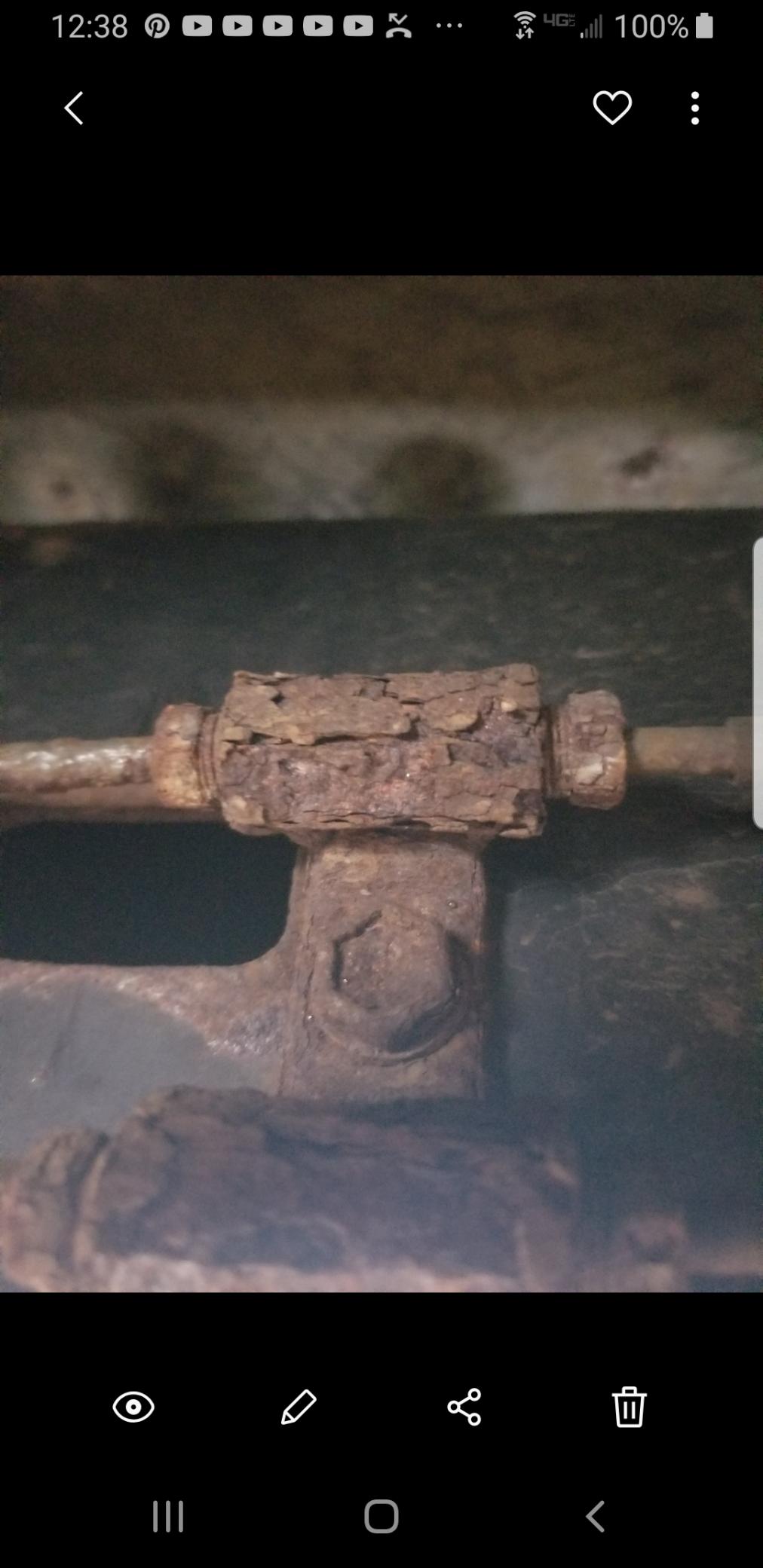

Ok. Thanks to you all I've sourced most of what I need. I think I should replace this line connector in the middle of the car. Im having trouble finding it in any catalog. Should I just go to the dealer or can someone give me an online link?

A double flaring tool. You can borrow them from most auto parts stores. As for that coupler, most stores sell them without the bolt bracket but you could make that yourself or just zip tie it in place.

The coupler 47322B
The bolt 91641-H0820

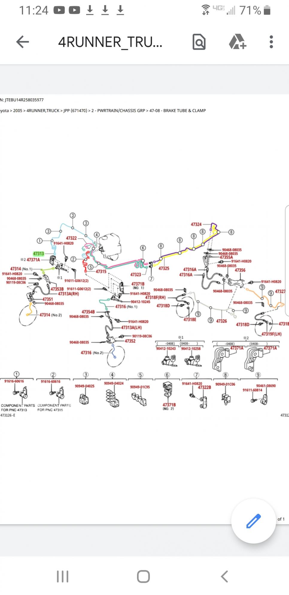

Here is a screen shot of the pdf the dealer sent me.
