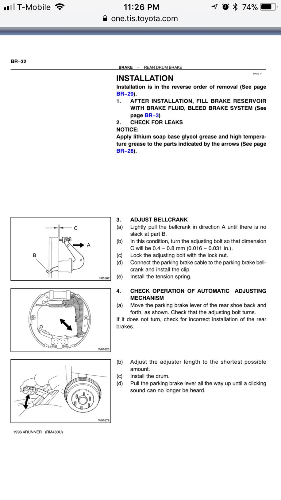

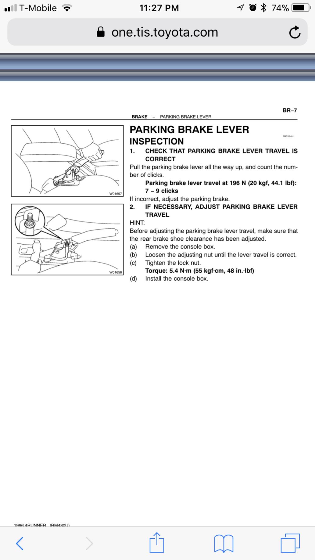

I can almost guarantee your problem is with the bell crank adjuster on the back of the backing plate, it’s visivle from under the vehicle so easy to adjust. Below on the FSM, follow procedure #3 to adjust that. If you do this and you get too many “clicks” out of the parking brake, follow the other attached FSM to adjust that. All pretty straight forward.

Thus morning I went ahead and dialed the star wheel about 8 clicks back. After some highway driving I pulled over and my passenger side was super hot, so I took it apart and turned back another 10 or so clicks. Now my driver side is hot. I loosed the bell crank adjuster so that it's as close to the backing plate as possible - I figured the closer it is to the backing plate, the closer in the hook is, thus giving it slack.
I'm going to take it apart for the 5th time and try to follow the FSM
I never adjust the bellcranks in any of the toyotas I deal with. The only adjustment I do is the star wheel on the brake shoes. Adjust it until it is not touching the drum and the drum is spinning freely. You should be able to slide the drum in and out over the brake shoes easily. Then put back the drum and pull the park brake lever 20 times or so.

You have yo pull the bellcrank as stated before adjusting if you don't you'll continue overadjusting using your HB

I went ahead and follow the direction. Pulled the slack off the bell crank and loosed the adjustment screw. Both of the parking brake levels inside the drum are now touching the shoe backing. The passenger side is great, but the driver still gets too hot. I'm going to replace the return springs on the Parking brake lever and see if that helps.
