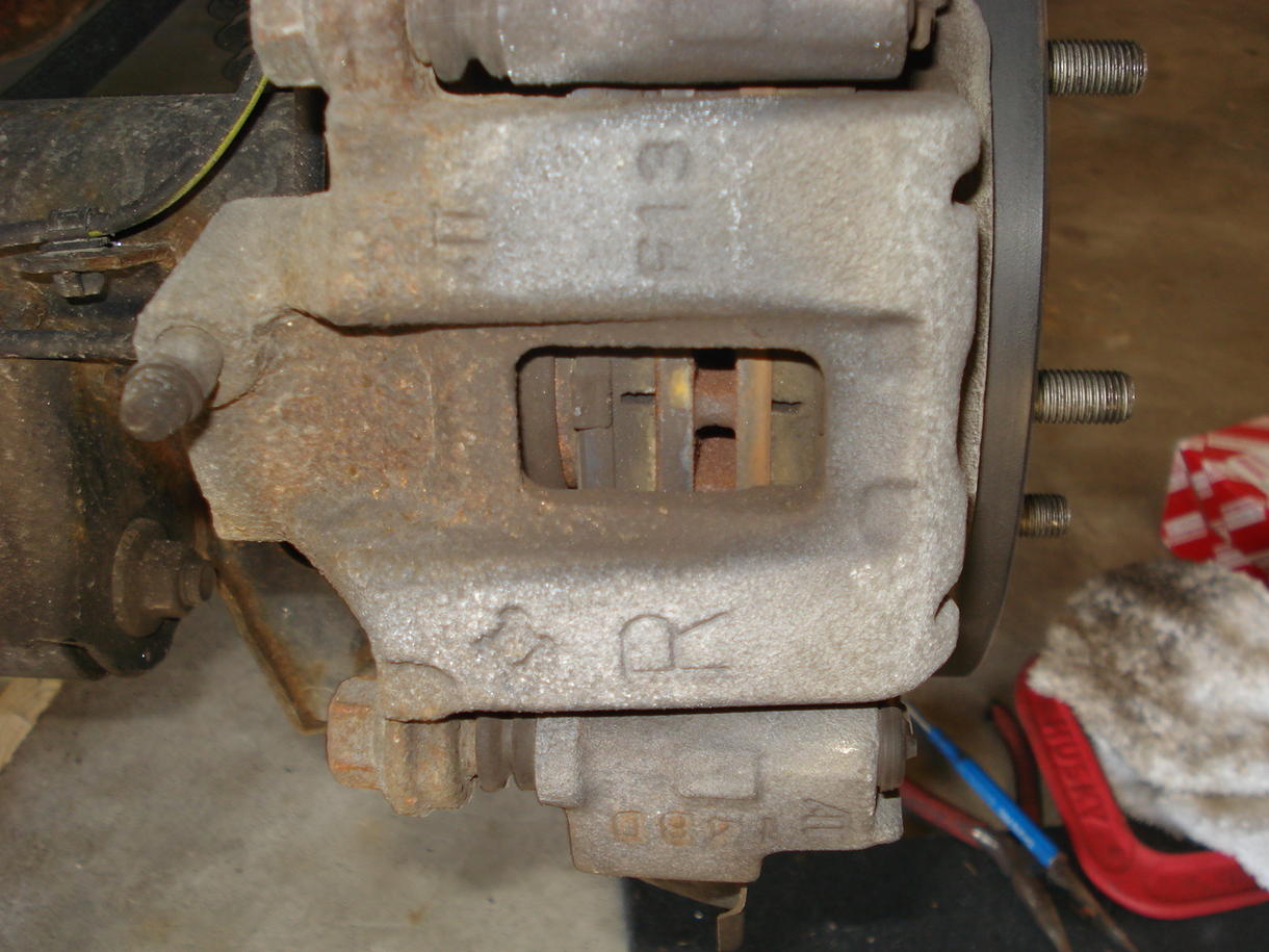

Hey guys,
I am finding a lot of video and write ups on front pad replacement, but looking for something on the rears.
I got the fronts done fine.
What bolts do I take out in the rear? It's a different set up than the front.
The pads just come out of the front of the caliper?
Thanks for the help.
Best regards,
Doug
Pull your slide bolts.(the ones with the rubber boot) slide caliper off. Push piston back in replace pads, install caliper and your on your way.
Also from what I can see in this pic your pads have over 50% of their life left.
Thank you men. I would have guessed wrong.
I thought those may unbolt the 2 halves of the calipers.
Yes, I was wondering about whether these needed replacement.
After my searches, I seen its not abnormal to change the fronts 2x the rears.
So, I'll hold these until I change the fronts again.
Thank you much.
