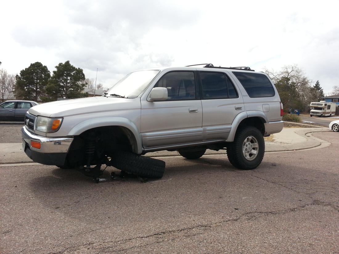

The rear end dont have ball joints but if your front right side is loose then yes you want to go with NEW OEM ONLY ball joints. Some have had theres fail when aftermarket in low miles. If yours is loose you want to quickly change them. Here is what happened when mine failed.

There are a LOT of people here who will disagree with that statement, including me. Everything from Moog I've bought over the last year has been junk. I'd stick with OEM for the lower ball joints at least. The failure mode could be deadly in this case.
https://www.youtube.com/watch?v=6h9xTCYC6Es
Don't use Moog ball joints. Your putting your truck, life, and everyone else's life around you in danger by using inferior parts there. Replace both sides as well, I'm going to assume you meant the front LBJ as there are none in the back.
