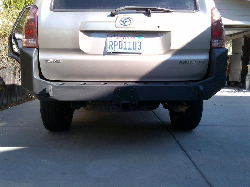

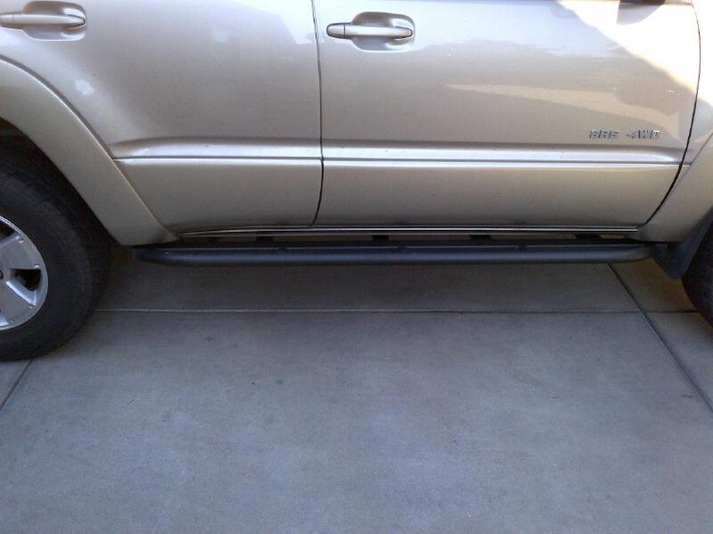

New rear bumper (aluminum) and sliders (steel) for 4th Generation 4runner built by Relentless Fabrication. Both fit like a glove.

The rear bumper is about 65lbs aluminum, 130 steel.
I'll take some more pics this weekend and post. The photo Eric posted includes my hitch mounted bike rack (so no one wonders what that is hanging off the back).

I like the idea of the lighter aluminum rear bumper. Also wonder how it would look color matched? Sometimes I think the big black bumpers look to obtrusive.
Great to see another rear bumper option for the 4th gens.
I'd have to see way more pictures, especially a side on shot...but from what I see in those pics, I like the lines of it on the sides and the fact that I can get it in aluminum.
Two things that bug me about it is how far it seems to stick out rearward past the tailights and the hitch plate seems large and obtrusive and looks to hang low.
I'm guessing it is bolted flat against the rear crossmember which limits it to sticking out a set distance, bit the areas below the tailights just seem to be sticking out.
I realize that the hitch tube is merely below the main body of the bumper which places it in a position as high as it can go...but maybe an option of having it in the main body of the bumper and the customer can cut the hole in the crossmember for the hitch tube to pass through?
Definitely interested in seeing more.

Im waiting on seeing pictures of it flexed out, Im wondering that it being so tight to the body panels Im affraid it will make contact, Im not sure how much the frame rails flex, the front is crazy lol

I don't think it will make contact, and if it were to, there is room for adjustment. His is mounted as tight as my design allows. The front of the Tacoma flexes like 1/2-3/4" but the rear not as bad so I'm betting its the same with this runner(especially with the massive rear crossmember)

Aluminum recovery points are 1" thick and 3" tall, vs 3/4" thick and 2.5" tall. They're waterjet cut from 1" 6061 plate, and welded to an internal gusset in addition to the face of the bumper
