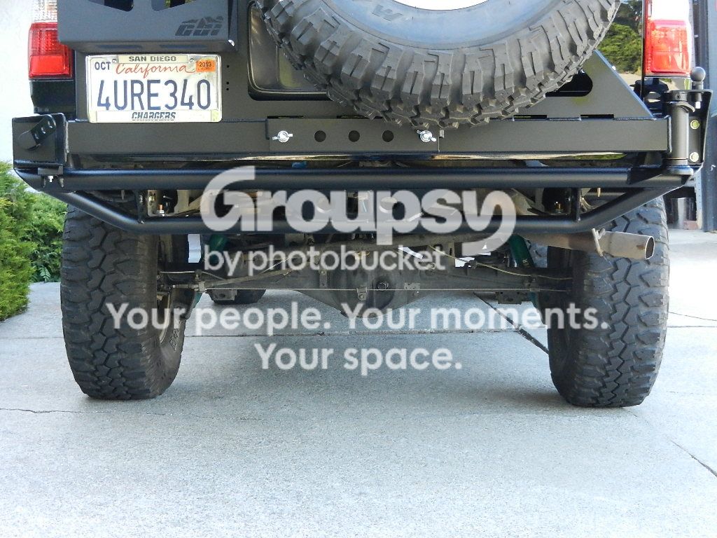

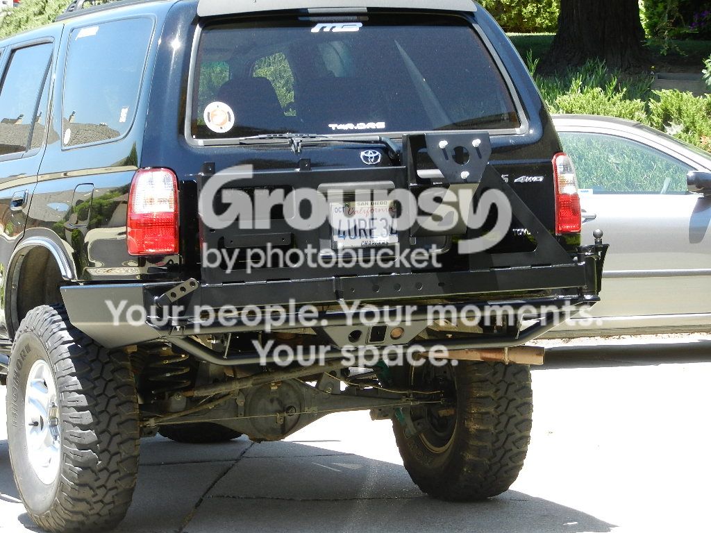

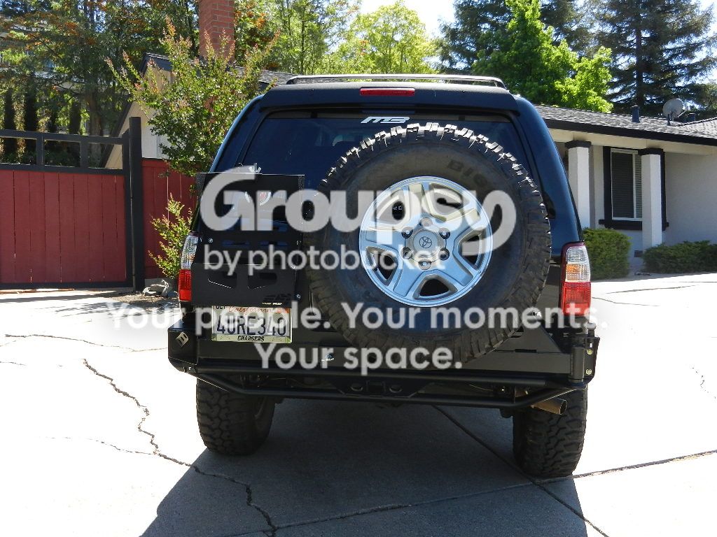

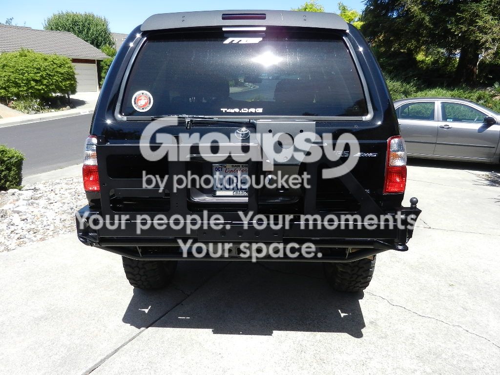

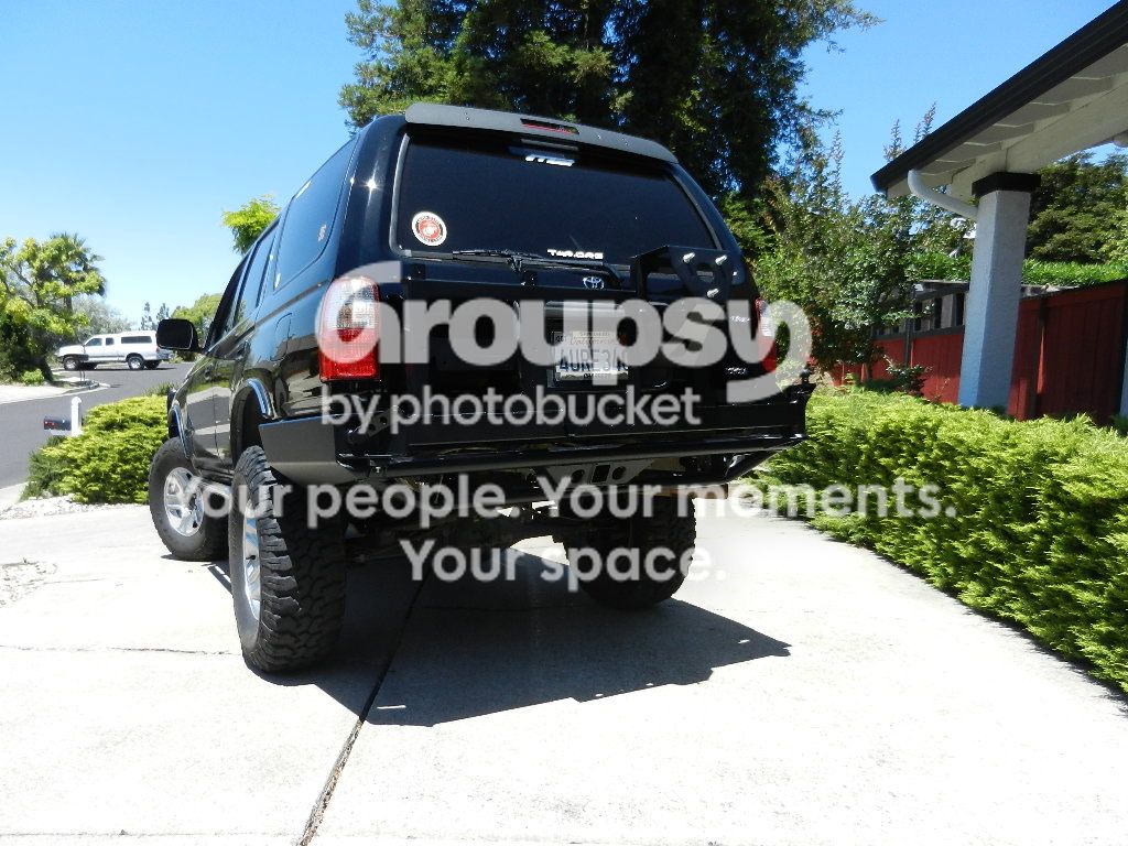

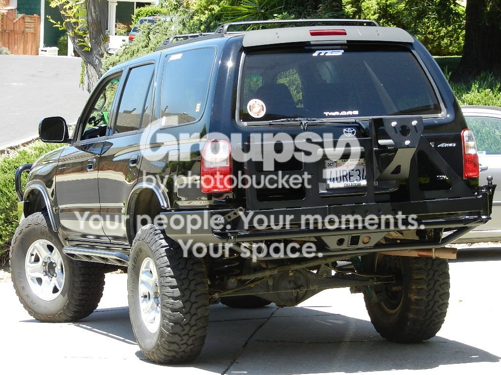

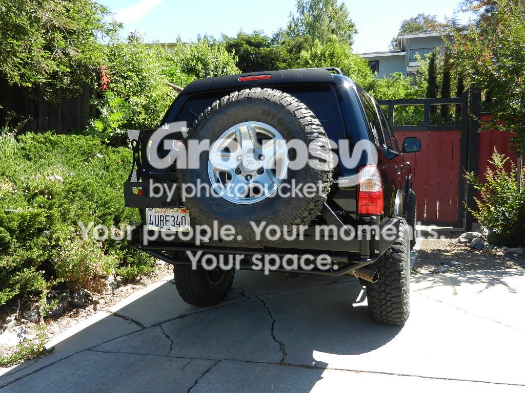

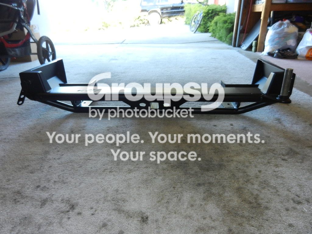

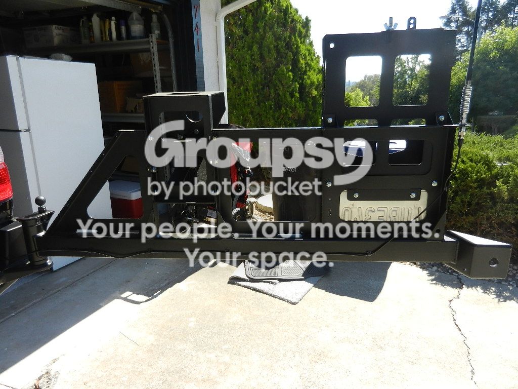

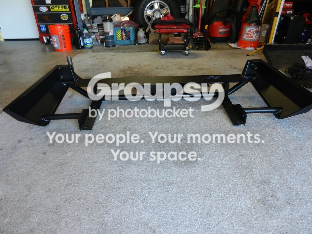

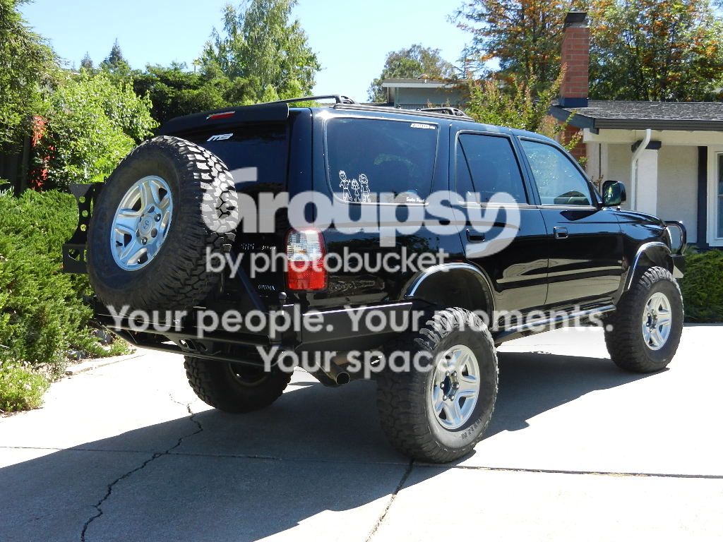

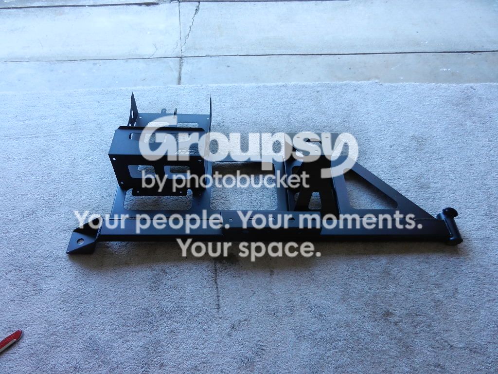

I haven't got that far into my build writeup where I cover the install of my CBI but here are some pics of it. I went with the hybrid with tire/gas carrier.

I really like that one, what flare option did you tell them you had? How much extra was the hi-lift mount... Any thing you wish you would have done differently or ordered in addition

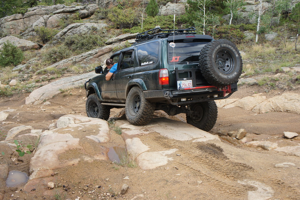

[MENTION=82211]TCMach[/MENTION] with his hybrid CBI for your viewing pleasure. I'll let him chime in on options he ordered/wishes he had.
I don't remember a flare option but I have the SR5 (no flare). The hi-lift mount comes standard. It's basically some beefed up wing nuts and bolts that you can attach to the back of the bumper in the provided holes. You can see them in a few of the above pics.
The only thing I would have done differently is see if there was a way to have a CB antenna mount on the opposite side (passenger side) instead of using the default one on the driver side. Reason being is I had to run the antenna cable all the way along the inside of the tire carrier swing out. Not that big of a deal but believe it or not the 18' of coax was too short to reach there and I ended up having to get an extension piece.

do they make that with a left hand swing out? or with the spare mounted on the left side?
I would prefer to have the tire directly behind the driver, an area you cant really see anyway, instead of blocking that right corner.
I'm pretty sure it's customizable. Why don't you reach out to CBI and ask? They are great to work with.
