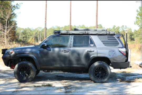

I recently had a 4x4 Labs bumper and Dobinsons 701v coils installed at the same time. They provide about a 3" lift. I didn't have to extend brake lines but haven't really stressed the new setup out yet either. Previously installed Durobumps in the rear as well. I had Duggy's Garage in Houston install the bumper and coils. They're basically Land Cruiser and Toyota experts but they essentially said I wouldn't need to extend brake lines. I trust their work and word. I think you're good without extending brake lines on a standard or extended travel setup but if you went long travel rear then for sure you'd have to extend them.

This is the perfect amount of lift for me (seen in picture)! What coils did you go with?
