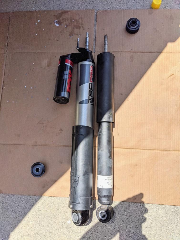

Solved! So I put the original shock back on with the same bushing and everything. Squeak is gone. I thought maybe it had to do with me cleaning everything, so I put the Fox on back in and well the squeak is back...
Luckily, I am still in warranty with the Fox shock, so sending it back for a replacement. It's weird to actually have a shock squeaking apparently, but that seems to be the case.
