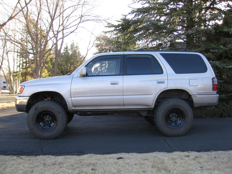

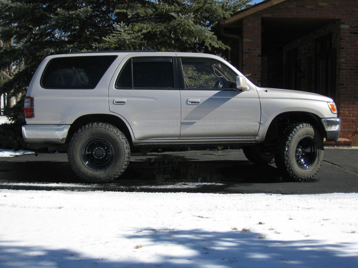

What year is your 4runner? I just inserted 890's from Toytec, They are actually Old Man Emu. Toytec claims 3"lift from them, but you have to remember they are spec. off something like a 96 or 01. When I intalled them I maybe got 1.75" of lift, I drive a 98. Ended up pulling them and putting the 1.5" daystar rubber spacer that I was intially sitting on w/ stock springs. I measure 25in from center hub to fender in the front, and 26in from center hub to fender in the rear. Maybe LC would work better? 7-8 coil?
Pic1.Stock coils w/ 1.5" spacer
Pic2. 890 Old Man Emu w/ 1.5" spacer
Ps. when I installed the 890 w/o the space it basically rode the same height as pic1.

I just measured what my my ground to fend height is and it sit at a little under 40in on the front... so if your at 38inches then the Old Man Emu 890's maybe just what you're looking for.... and the 890's are maybe a smiggin harder than my stock 4runner springs. So if you like the way the rear rides now, I would suggest 890's. LC if you can find the same color codes for bothside or it will ride about an 1in high on the driver side.
