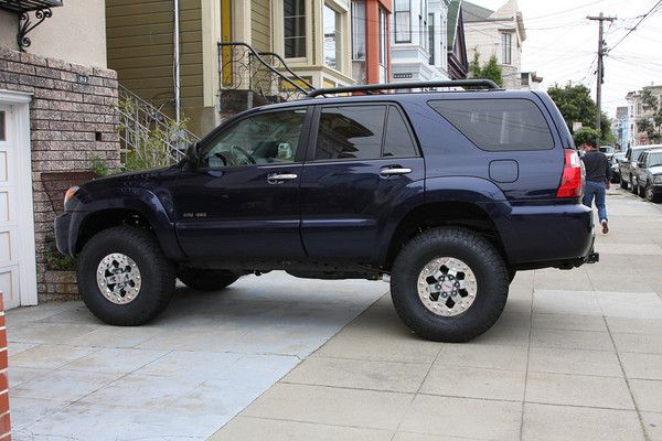

well i dont plan on rear bumper whatsoever...(2wd) and most of the time it will be unloaded. so i guess ill look like this but i might go 295 instead of 315.... is this unloaded pitbull?

That is unloaded and I lifted the front a little too. I can dig up some FJ pics to see what its like loaded down. IMO, the 3.5" is too high without any weight. You'd have to go pretty high in the front to even out, past your CVs limits and also the coilovers limits. You'll need a diff drop wich will reduce your clearance assuming you crank the front coilovers to even out. I'd look at Toytecs Superflex coils, they lift more than Icons, but not as high as AP 3.5" from what I've seen firsthand.
