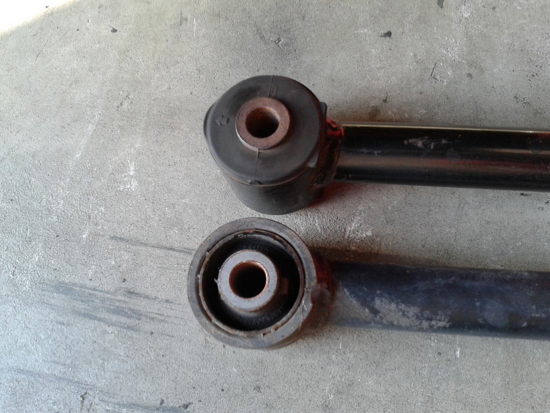

I picked up a used pair of rear lowers today. Look at the photo. My truck's arm is on the bottom. Look at the bushings. My truck is an 01. The top one I was told is from an 01. I've never seen them like that. They are solid and intact. Any one know what year truck had bushings like this? They are far more hefty than the lower one.
