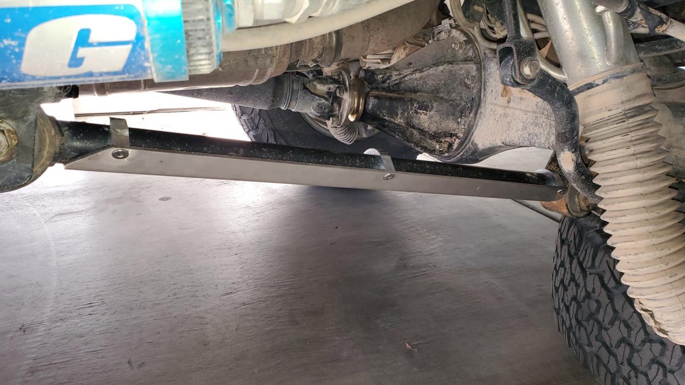

I have had the Rokmen arms for about 4 years now. They have performed admirably and held up to getting thunked more than a few times. I feel a good complement would be some skids for the arm mounts.
The WL bushings have done their job well, albeit for about 4 months so far.
I haven't found any drawbacks concerning road feedback or articulation.
I followed their recommended greasing procedure and they haven't made
a peep - especially considering the trail conditions right now. I could survive
an annual re-grease, but fingers crossed it takes longer than that!
