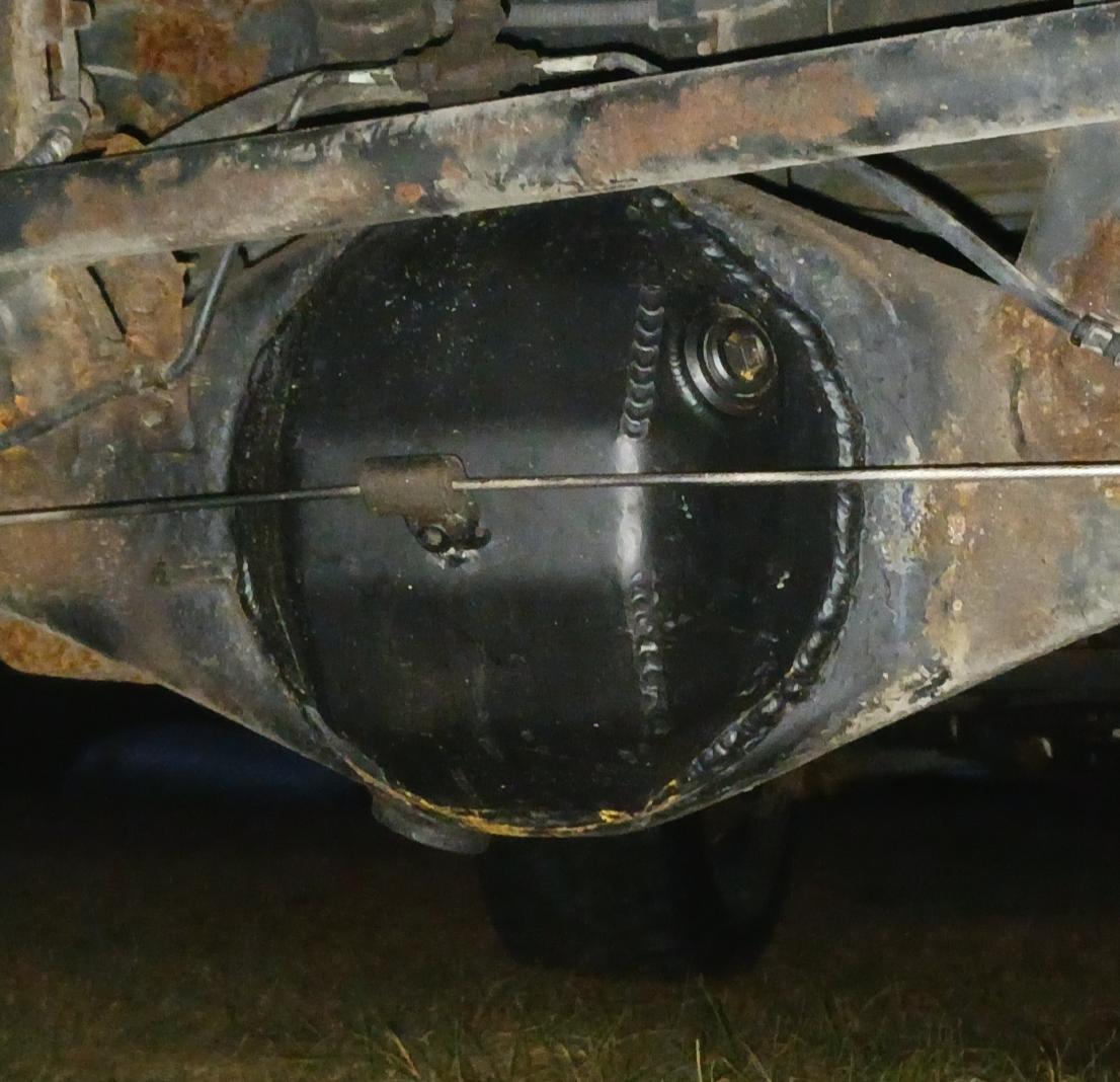

I live way up Carova Beach on the OBX, also known as the "4WD Area" of Currituck County with no roads, signs, mail delivery or lights. It's pretty rough on the ride with all the salt and sand dunes and rough terrain. It's 15 miles up the beach to get home. Blew out my rear end after the dreaded pinhole leak ran her dry on my 2000. I had a hell of a time identifying the gear ratio as there are several for that year. I called several dealerships with the VIN and noone could give me a straight answer. I finally remembered a guy at Bennet Toyota back in PA who always went the extra mile for me back in the day and he was still there. Sure enough he looked up the "sales code" associated with my VIN and figured that it was a 4.10. So if you have the same problem ask for the sales code. So, I picked up a clean unit from ebay for 475.00, cut off the old cover and welded a new Barnes heavy duty cover on and I'm back in action.

So the Barnes Cover clears the lateral control arm? I need to do this to one axle housing and was wondering if the cleared standard height non lifted properly. Or will have have to goto a dorman style oem rear diff plate.
As I have seen some of these heavy duty covers not clear the control arm and thus damage the rig gear over the years in various forums and posts..
So any feedback would be great. :-)
I'm lifted 5 inches so I'm not absolutely sure but I'm pretty sure it wouldn't be a problem.
