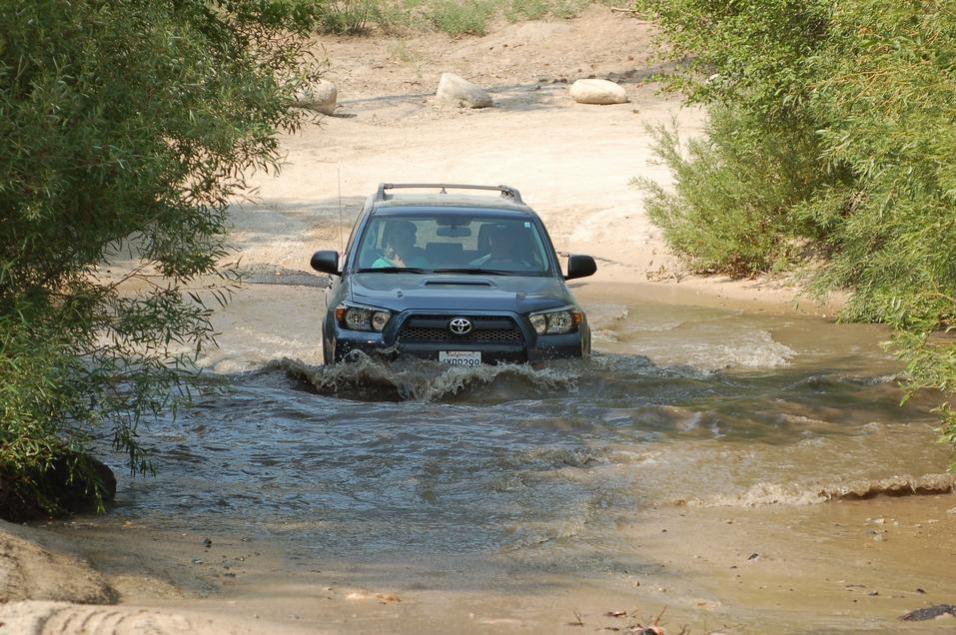

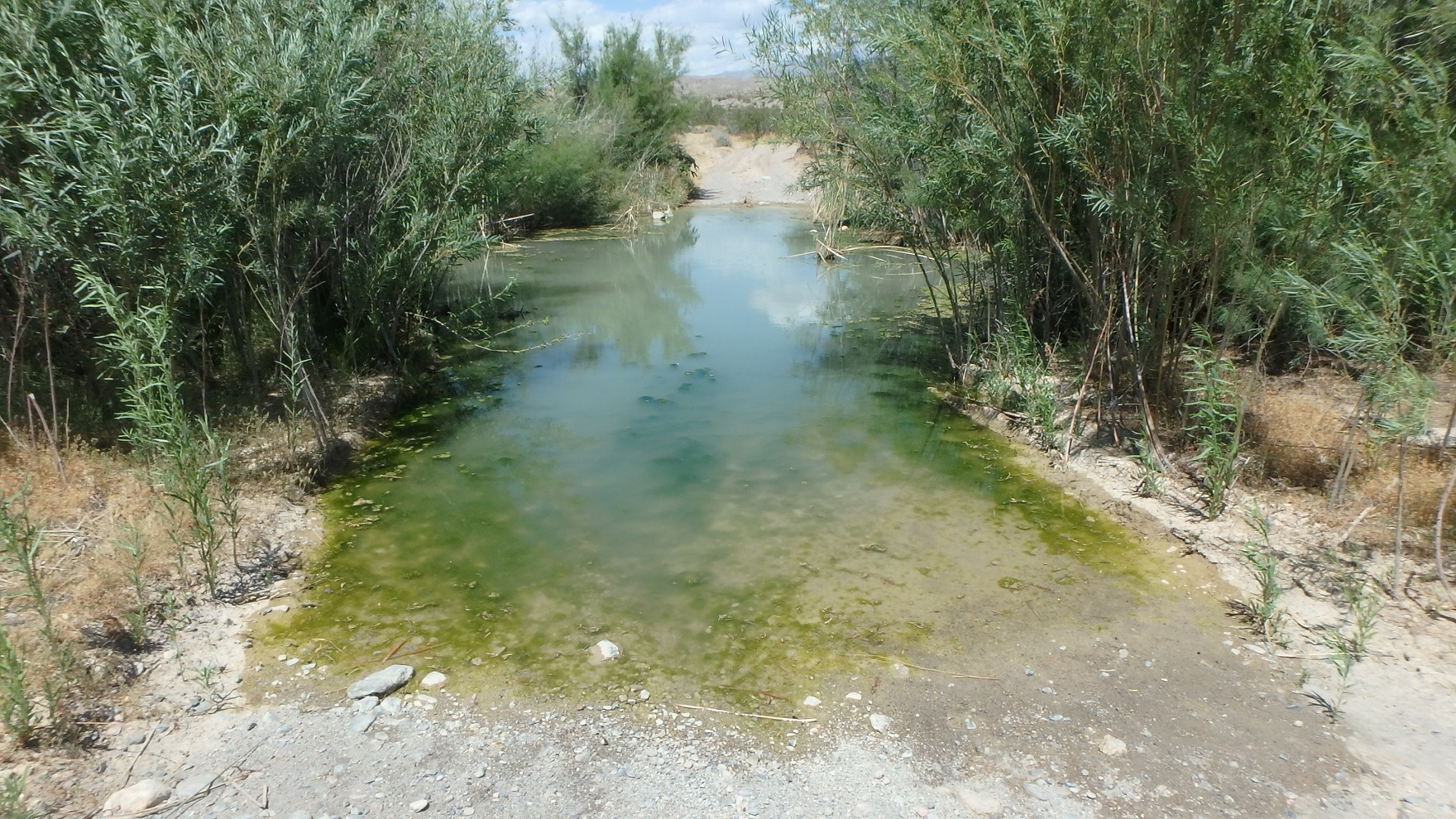

FYI, below is a pic of what I found at the infamous Meadow Valley Wash crossing.
I've been there before, when the pond wasn't as wide (and not as nasty). That time I waded out and turned around after I reached knee-deep water. So it's safe to assume it's even deeper now. But I wasn't about to wade out this time to check! It was on to Plan B. :heh:
