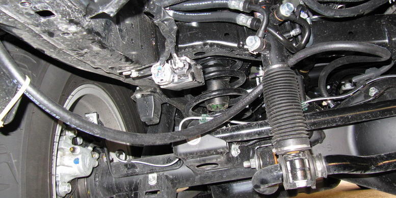

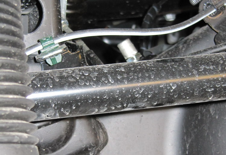

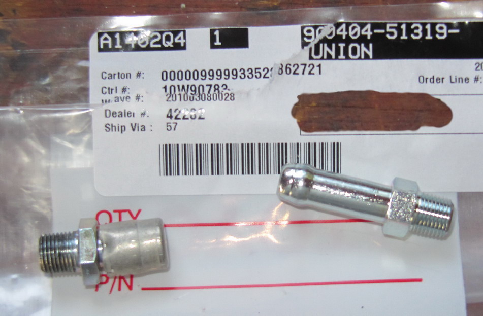

I extended my rear diff breather on my 5th gen TE from the axle itself to the gas filler area like I did to my 4th gen SR5 4WD. The first picture shows the stock breather in place. The second picture shows the stock breather removed and the tubing barb fitting that replaced it in the rear axle housing.
I put teflon tape on the tube barb fitting and screwed it into the axle housing. Attached 3/8" fuel tubing with a small hose clamp. I tied the tubing to the suspension link (not sure of proper name) using a cable tie (near bolt head and bracket to left of KDSS cylinder) and made a lazy loop to the plastic trim behind the rear tire where I tied it again with a cable tie.

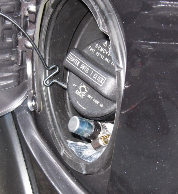

Fishing the tubing up to the gas filler area was a little tricky. First you have to remove the fuel door latch by removing the screw and then the latch itself. From the inside tool compartment, you can reach the back of the latch and squeeze the ears that hold it in place and push it out. Once these are off, remove the circular metal wires that hold the rubber in place at the outer lip and around the filler tube. Then you can run a coat hanger or something down to the bottom of the fender to attach the tubing and pull it up.
I cut the rubber to the lower right of the filler neck and attached the new breather fitting with a hose clamp(below). After reinstalling the latch and circular metal wires, I duct taped around the hose to minimize dirt entry into the tool compartment inside the fender.

Tonight I pulled it all out and added a tee fitting (1/8" x 1/4" x 1/4") to tie the rear axle and rear locker together and route to the gas filler area using 1/4" tubing. I placed the tubing above the filler neck this time and perforated the rubber between the filler neck and the inner wire retainer to prevent binding of the the tubing. There is already an oval hole there that I assume drains gas overflow or water from the filler area. I cross slit the oval hole to fit the 1/4" tubing better. This time, I passed the hose from the filler area into the jack compartment by making another small slit above the gas door latch. I sealed around the tubing with silicone to prevent dirt from entering the jack compartment. With this routing, you can use pretty much any size filter (within reason). I used an inline fuel filter with 1/4" fittings.
The procedure is basically the one documented in the FJ forum works (SCUBA DRIVER MOD: Breather tubes - Toyota FJ Cruiser Forum), except that you will need a smaller filter or breather cap if you terminate the vent tubing in the gas filler area.
