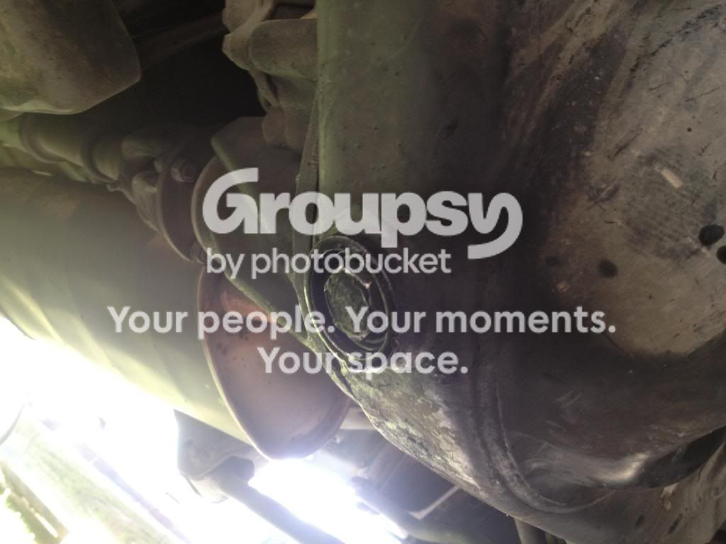

Update: Yesterday morn I made a sling to support the free spinning drain plug to prevent the plug from completely falling out and drove my runner over to a friend's shop a few miles away.
He brought out the impact wrench to see if that would pop it loose. No luck. It appeared as a scientific anomaly to us, as the plug free spun so easily you could turn it with one finger, yet it would not come out with the impact wrench, vicegrips, flat head pry, nothing. Once we gave up on getting it out easily. I just spun the plug with the impact wench until a small amount of liquid leaked out. When I stopped with the wrench, the leaking stopped.

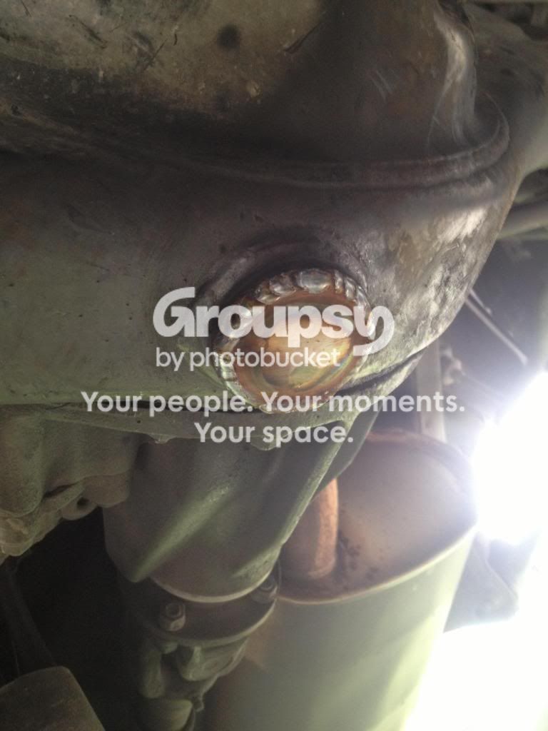

Anyways, I depend on this car for work, and would rather not have it out of commission unless truly needed. So in order to insure gear fluid stays within differential we welded a cap to the housing and enclosed the free spinning plug. That way when I have the time and money I can grind off cap if desired and properly fix the issue. Lastly we hit it with some high heat paint to prevent rust and such.
For now, I will use the fill plug and a hand pump empty and fill fluid and hope the drain plug magnet continues to catch shavings.
Before
Before.jpg~original
After
After.jpg~original
