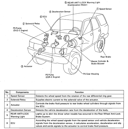

The older 4runners, ie:93-94 had the abs sensor in the center differential.
Found this picture in alldata here at work.
Maybe the axles has been changed out for an older unit? Or at least the 3rd member?
I'm thinking this is the more likely scenario. Perhaps an attempt to swap in factory 4.88s...
