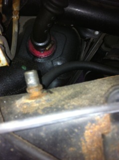

i read up on diff breather in the forum and will take a look at mine to see if it's clogged. Do I have to locate it, remove it to inspect it or can I determine if it's clogged without removing it? I think someone said it's 14mm. Just watch out for hissing pressure gas relieve?

The stock breather is the one on the left...
twist it to knock excess dirt loose, then you can pull straight up on it to remove the top cap and make sure it's clean, it's got a little "pad" and spring in there.

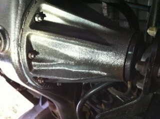

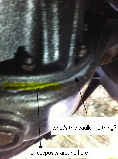

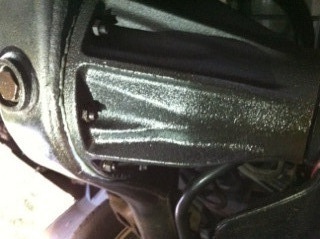

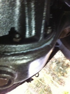

i found the rear diff breather and cleaned around it but couldn't pull the cap up and off after numerous counter-closewise turns. the cap can be pushed down a little and it springed right back. the base of the cap seems not round but intentionally shaped like a square so it doesn't come loose and off. the bolt the cap is on still has some threads left making you feel it's not completely threaded into the diff. i *guess* the breather might be okay since even before i cleaned around it, the cap didn't feel stuck.
on the other hand, under the rear diff, i saw this caulk like gray color stuff between the axle and the thick end of the flange (? is that the name for the cone like twisting part between the drive shaft and real axle, the front of which is narrow and back is wider ... ). i seem to always see oil around that caulk gap or maybe it's just oil running down and deposited there as it's a lower part of the diff, but now as low as the drain plug.
Breather looks fine, bounces back, and I think a little threads show from the factory, it's just a vent basically. No dirt, no worries.
It's RTV silicone for the gasket between the housing and the differential is the part you called the flange. It's also called a carrier or a third member.
I'm sure it's from the pinion seal leakage.
