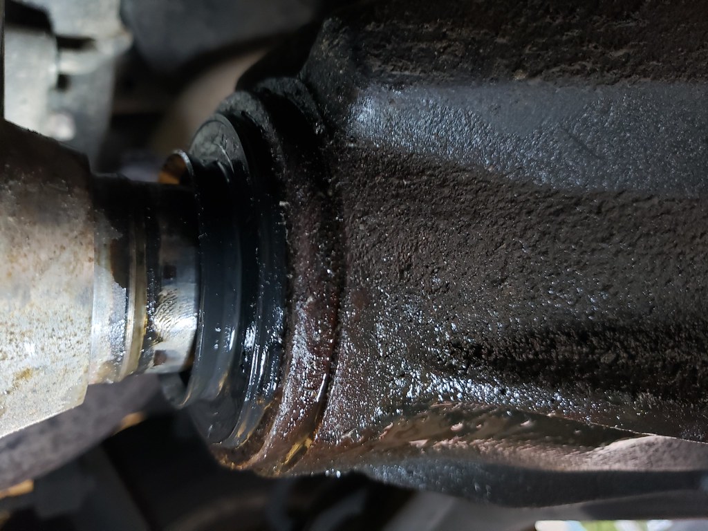

Do you guys happen to know how far in the rear diff (8") pinion seal is supposed to seat?
20190430_192253 by Nathan Guice, on Flickr
I've gotten it in about this far and don't want to trash it by pounding it any harder, but it doesn't seem to want to go in further. Roughly 1/8" still sticking out of the diff housing.

it should seat flush.

Thanks, I managed to get it in, but it seems some of the rubber on the edge of the seal tore off in the process so it's leaking from between it and the housing now.
Gonna grab another tonight and do a better job prepping the seal.
Is it better to do some black RTV or just grease it to drive it in?

I could see where the outer rubber was ripped in your photo before you got it all the way in...just use some of the diff fluid to lube it to help it go in otherwise no other prep needed to the seal itself...BUT most important is to make sure the recess where is goes into is clean and has no burrs, etc., and also extremely important is to drive it in evenly, if it goes in even slightly cocked it will rip the outer rubber again, if your not using a seal driver you need to be so it goes in straight, tapping it in on the sides will not work and you'll be doing it again and again, many of the major auto part stores have such tools they will loan or rent to you.

Not sure on the 4Runner because I’ve never looked at the pinion directly, but generally on the ones I’ve worked with, the seal is seated flush with the housing. I’ve never seen a seal walk out like that before though. I’d be concerned that the pinion bearing may need replacement and is allowing movement that pushed the seal out.
