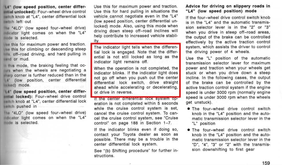

I rarely use these buttons but I know one of them requires you to hold it down for a few seconds. Maybe that's the RSCA button. Page 159 of my '04 manual says that if the center differential doesn't engage and the light flashes to drive straight ahead while accelerating. Cold weather really affects both the center differential and the 4LO action but warm weather doesn't. If your center differential doesn't lock after the manual's instructions I think you should take it to the dealership.
