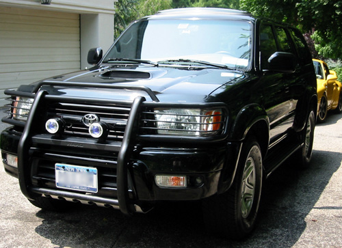

I have a 2000 4Runner SR5 Sport (hood scoop opened), 5-speed manual transmission with TRD supercharger, TRD supercharger belt tensioner, TRD cat-back exhaust, TRD air filter (air box opened), and TRD brake pads. I have Toyo Proxes S/T tires (+ 1 size) on 16" five spoke OEM rims.
I have over 325 hp and over 350 ft

Is that a 911 turbo I see in the background? (Me a Porsche enthusiast).
