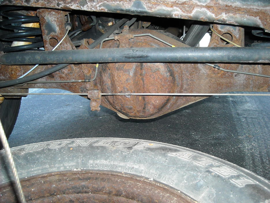

Pics of rear axle housing...
yes....i am mistaken...it is the housing...I will sen out a couple of pics...
Main area of concern...

Yup...
Does not look like yours has rusted through...yet...

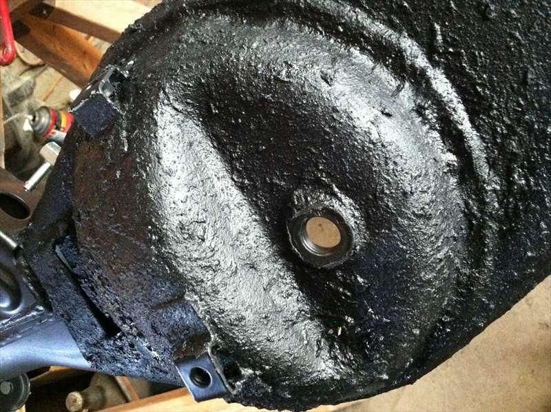

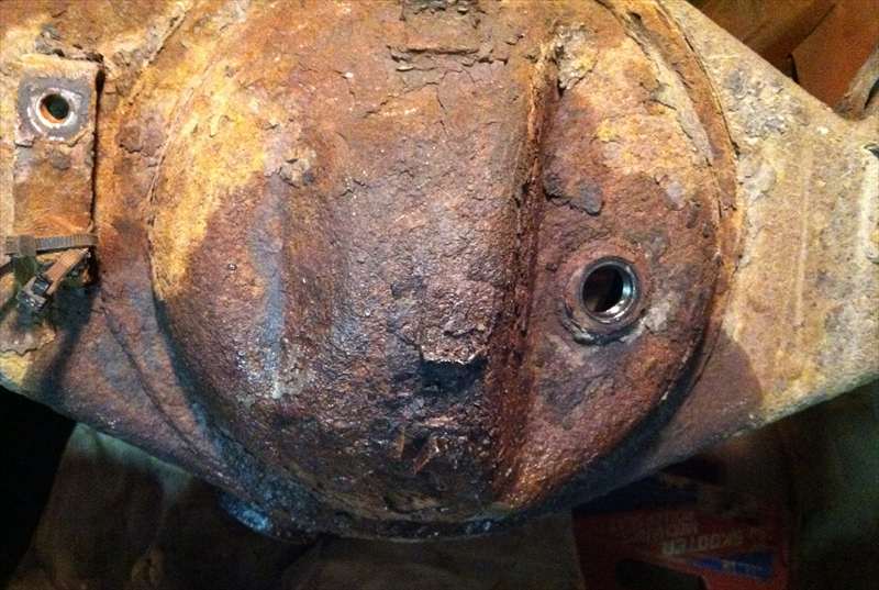

In a way you are lucky, as that broken e-brake guide bracket rusted off on yours... Mine stayed there, rusted, and vibrated a crack in the non-replaceable differential cover...new dealer axle housing - $1100...
Again, if you check out my repair thread you will see what I had to go through... But as I mentioned, if you that the time, buy a used housing and have it shipped in... Then clean it up as best you can before it goes on the truck...
I am a fan of bedlining anything that does not have bolt threads or moving parts... I think my new axle housing will outlast the rest of the truck now...
If you are extremely ambitious, you could attempt to clean up the one you have, prime it good and thick, then bedline it... It all depends on time, money, and how long you are able to be without driving your T4R...
I was lucky and had access to a heated garage over X-mas break...

Flifisher, you have the typical rusted axle housing. No surprise since you are in NH. I had the exact same thing as my rig has lived in MA and VT. Is your housing rusted all the way through already and leaking?
Even if it has rusted through, it can be temporarily patched, and there are other, much cheaper courses of action than what Dewey did. Don't read his thread and think you have to do the same, he replaced and spent way more than we necessary. He has alot of new parts now, which is great, but not all of them need to be replaced.
The link in my signature shows some of my rust issues. I used JBweld putty for a patch until I found a replacement axle housing. Other guys have used a JB weld patch for over a year without problems. This at least buys you time if you are indeed leaking. Also in that thread are links to other very useful rust threads, one showing a guy that had his welded, which is another option.
For now, I recommend stripping the rust off the diff cover area and assessing the rust holes. Remove the fill plug, drain the oil, and patch the holes with JB weld, then refill the diff and spray some paint over what you stripped. Just a couple hours of work and you will be back on the road, then you can look to the permanent solution of replacement.
