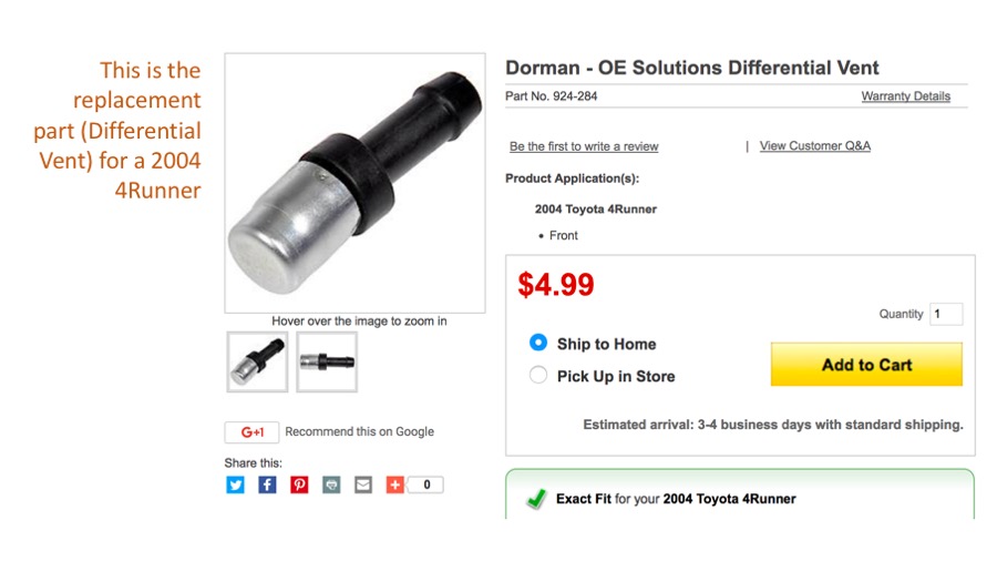

I lowered the spare tire and took a look down there. It seems to be the small valve located on top of the rear diff on the driver's side and it indeed look kind of rusty.So I think it might be better for me to just replace it.
But I couldn't find it on toyotapartsales.com but it is not drawn in the diagram of rear axle and diff and there's nothing listed as a vent,valve or breather under that category(rear axle and diff).
So I'm wondering does anyone know what's its name and part# and could you kindly help me out?
Thanks!

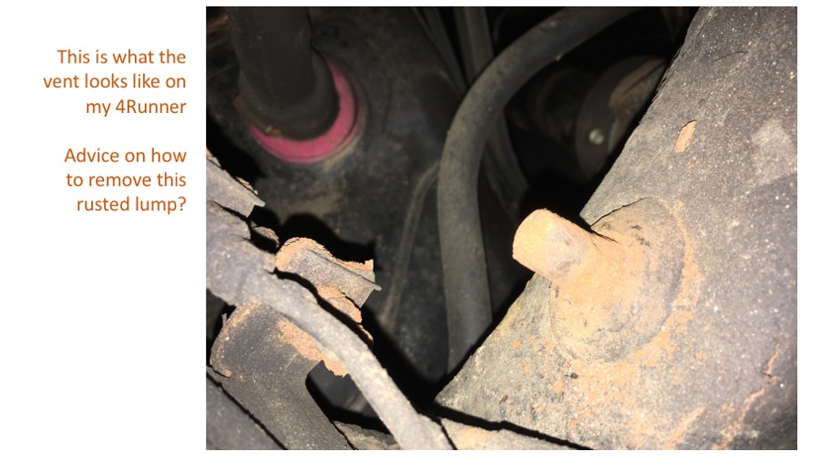

My axle seal is leaking. Likely because my differential vent (breather) is frozen. Advice on how to remove this lump of rust?

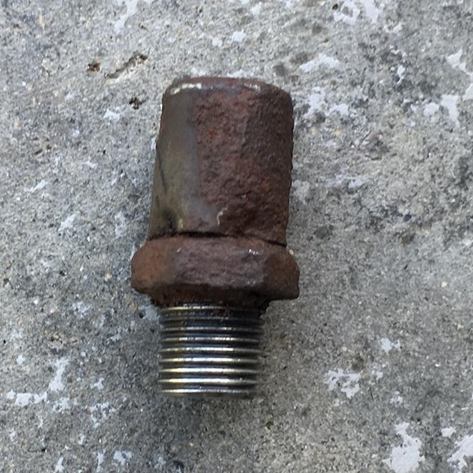

It's off! Hit it with PB Blaster. Waited 30 min and took it off with a 14mm socket. Next is to fix the rear axle seal.
that looks nasty, do these use the same parts as tacomas? I saw a Tacoma thread with part numbers for the hose nipple fitting to fit the axle threads and a vent cap to put on a hose that you mount wherever you want it
If that vent has pipe threads I would get a male barbed fitting, thread that into the axle housing and a hose on the barbed end to route it to a location where it easy to get too, attach another barbed fitting with a female end attached to the hose and a new or cleaned up vent attached to the female fitting and you can inspect/clean it periodically with ease in the future.
The hose will need to be oil resistant.
