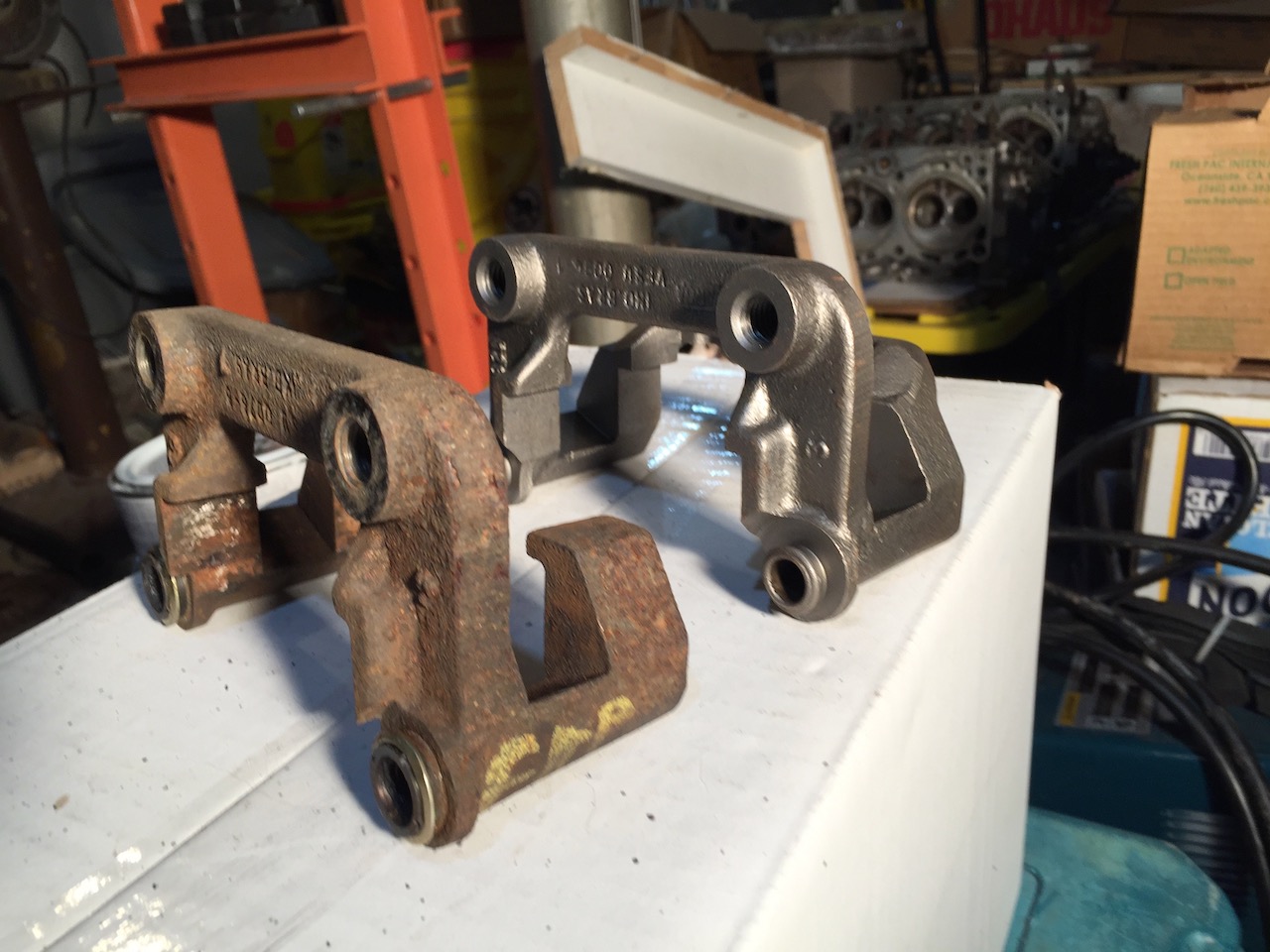

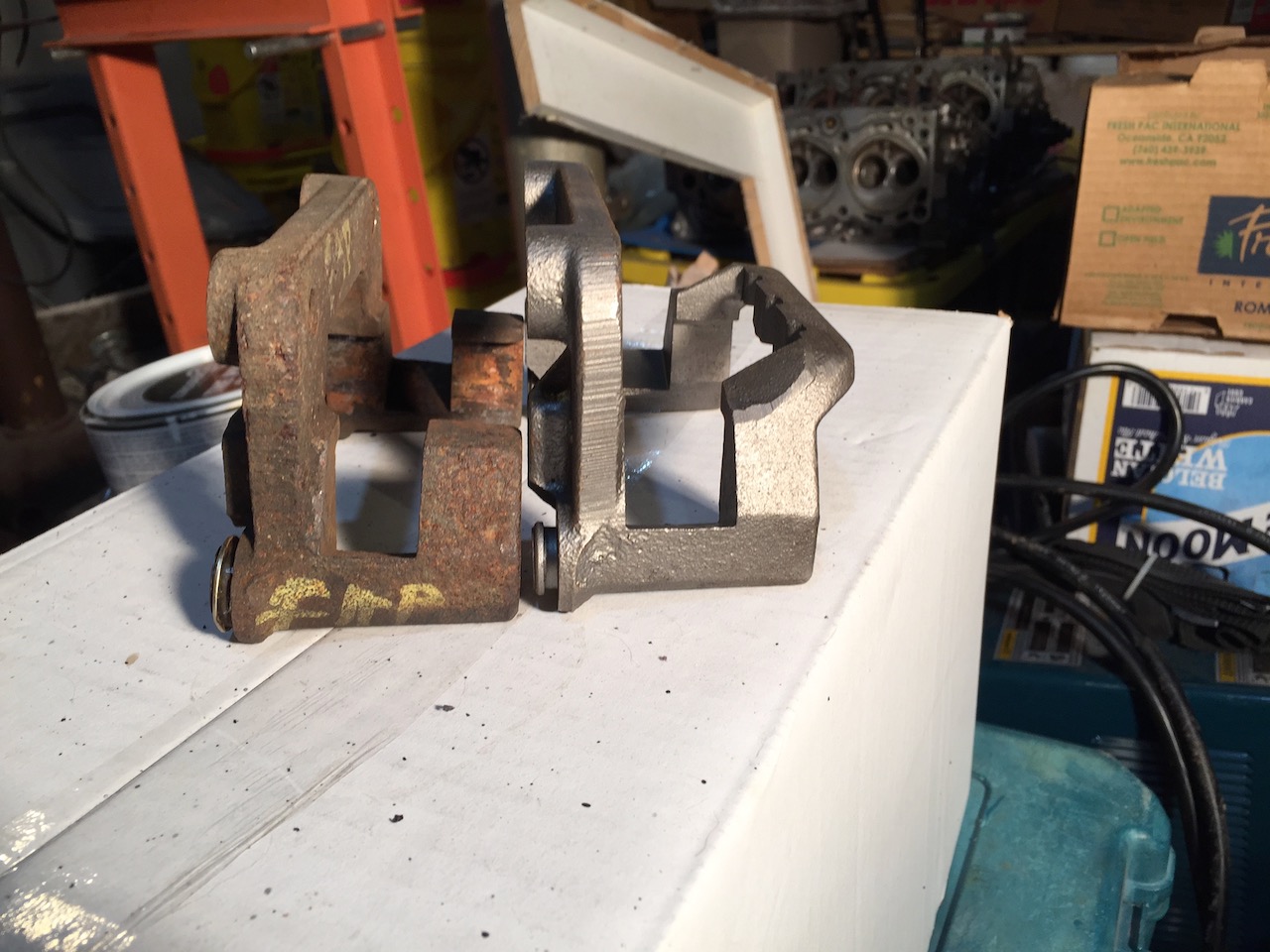

And now I have solved the bracket clearance problem. As promised, my local AutoZone came through with overnight service to get me a caliper bracket for a 1998 Mustang Cobra, and as I suspected, it fits the GT caliper perfectly and it has a wider gap to accommodate a thicker rotor. I said earlier that I had read that the GT and the Cobra use the same caliper. That was true. They also use the same brake pads*. The difference is in the caliper bracket. The bracket that comes with the GT caliper is made for a 14 mm thick rotor. The bracket that comes with the Cobra caliper is made for an 18 mm thick rotor. The brackets are available separately from most auto parts stores for around $20 dollars plus a six dollar core charge. And of course you can buy the correct assembly, caliper and bracket together or even buy them as a loaded assembly caliper bracket and pads.
This evening I have installed the modified assembly along with my custom made bracket and the fit is perfect. The rotor is well centered within the caliper bracket and the clearance is good. I would offer a picture, but that stuff is outdoors and the lighting is inadequate for good picture taking. I will take care of that tomorrow. Happily, I can move on with my restoration and upgrades, the ultimate goal of which is to get a 2.0 l turbo diesel out of a 2004 or 2005 Volkswagen Passat installed in my truck this spring. I am hoping that Diesel Conversion Specialists will have their adapter plate for the "R" series five speed manual transmission available after the first of the year.
Pictured below are the two brackets side-by-side, with the GT bracket on the left and the cobra on the right.
