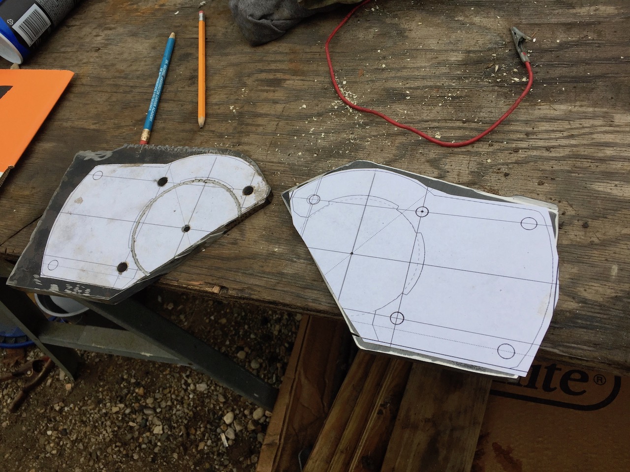

I am finally getting around to making some parts for this brake conversion. I am going with the SleepyDad version, using 4th gen 4runner rotors and late '90s Mustang calipers.
I found that I could make the drawings for the parts in the free, open source drawing program called Inkscape (it's like Adobe Illustrator). I could draw the part to the dimensions I wanted and get those dimensions to print to paper with a pretty good amount of precision. Then I just cut what I need from paper and use spray adhesive to stick it on the metal. I check the work with a caliper as I'm going along, but so far the paper Has proved to be quite accurate and is a real help in doing the layout for the machining work that is involved, which amounts to drilling six holes, including one hole drilled with a holesaw to four inches in diameter.
I got a fantastic deal on the steel. I picked up about 4 square feet of the 3/8 eighths inch steel for four dollars at my wonderful local recycling center, where they recycle every thing from household goods to industrial and agricultural equipment. The place is a veritable goldmine for a guy like me.
