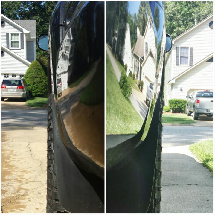

I just noticed that the rear driverside wheel sticks out 1/4-1/2" more than the passenger side. Is this normal on 4runners? I looked at 2 other stock 4runners and it kind of looked like they did too. It was really hard to tell/measure though since their wheels were stock offset and sunken into the fender.
My set up is Daystar 2.5/1.5, spidertrax, and 265/70/17. I just go an alignment also. Rear camber is -0.1 on the rear driverside and -0.4 on the rear passenger side.
