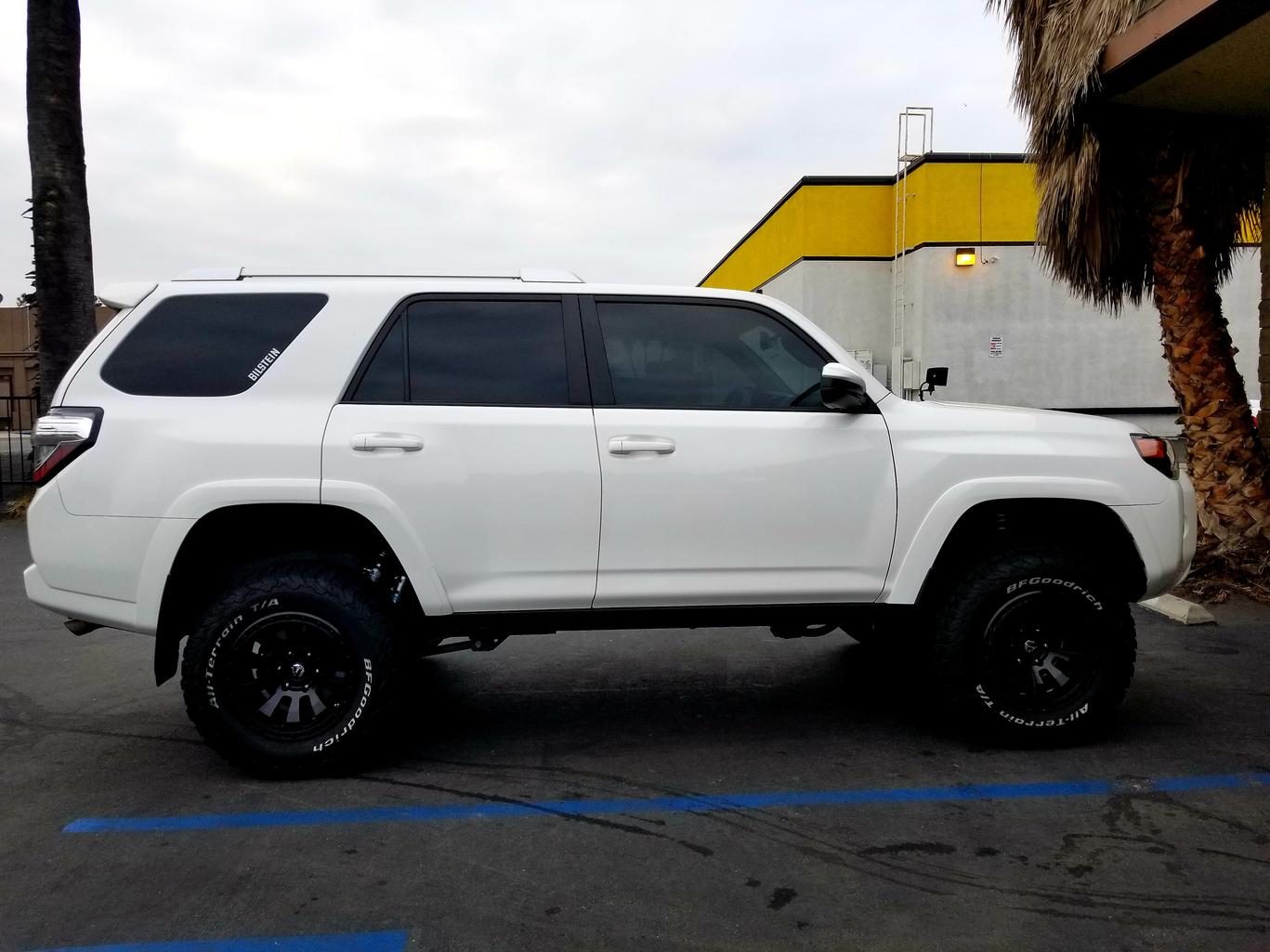

Hey there,
I've seen 'clunk' threads over speed bumps - there is no sound besides what you may expect a suspension hop to sound like from a vehicle.
Here's the set-up: rear Toytec 2" Superflex (not HD) coils paired with Bilstein 5160's. Super common, well more so with 5100's, so hoping someone else may be experiencing this & hopefully knows of a fix?
Super annoying because I have to slow to a crawl in order for the rear not to jump when going over a speed bump. This was something I never experienced when I had stock coils on 5100's.
Do I have to just get used to going 1 MPH over speed bumps in order for the rear not to bounce up so much??
